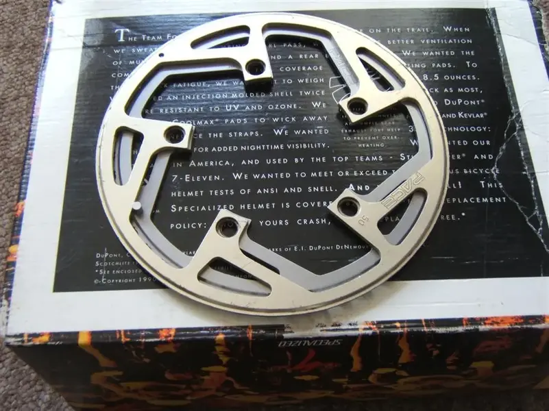

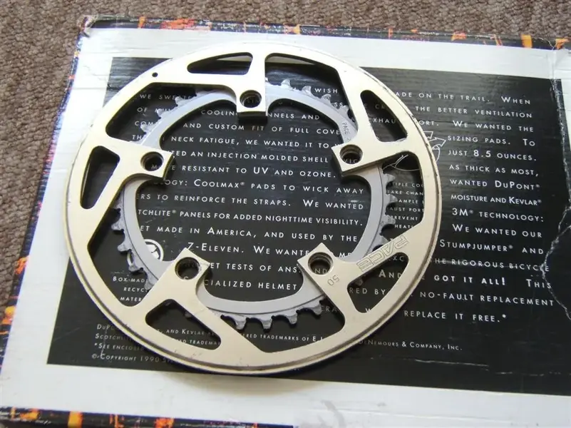

What looks good and is very practicable is to take a say 46 or 48t outer and grind off all the teeth (ill show you a pic tomorrow) You put that on the outer with your 36t in the middle spot then you need only standard outer chainring bolts. There will be a fair bit of weight on them especially on inclines so best stick to stainless.
Plus the bigger outer stops the chain jumping off the top, if anything catches when she changes gear as we all have no doubt experienced :?

Pic
Outer 50t ground off with a 46t and with a 36t to show you the comparison.
