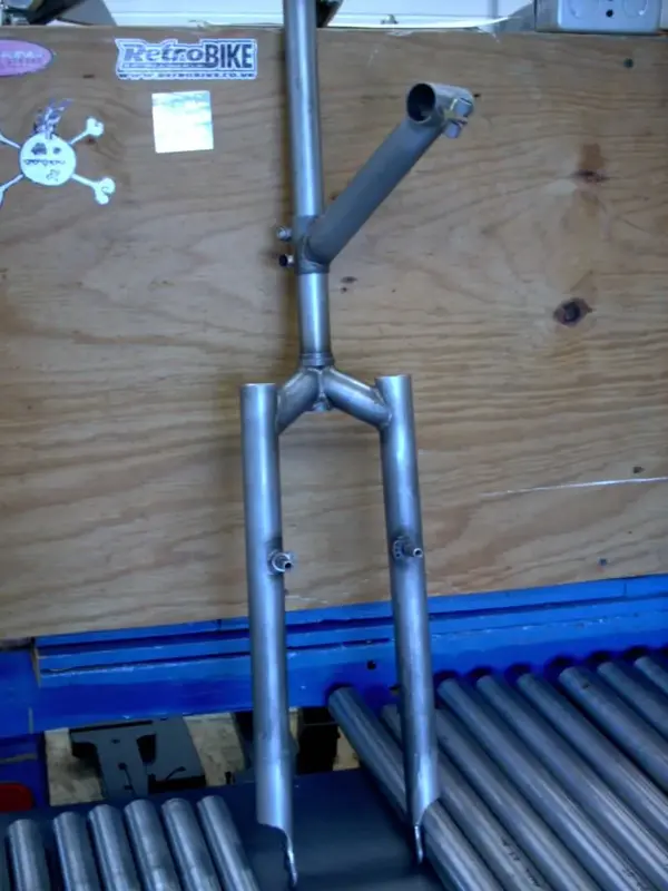

I just fabbed up this baby yesterday...a crown forward Yo style fork and custom stem...
cheers,
rody
