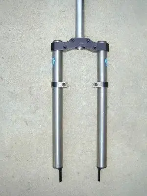

I like to see a rigid fork like the McMahon titanium 8) (see pics),
nice ti
i also would be more interested in legs that fit my rc 30 crown, those forks pictured above are well nice!!!
