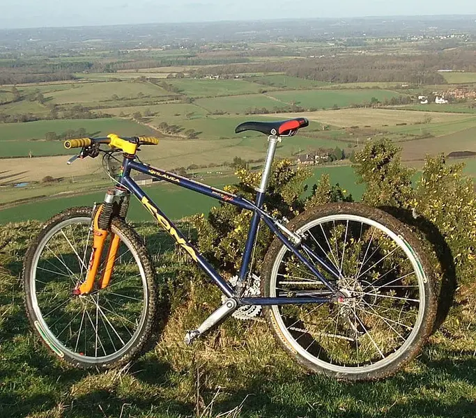

Not impossible, just depends how period-correct you want to be. This is a 97 bike and so are the Manitou SX-R forks. Theoretically they have 63mm travel, but realistically more like 40-50, but they do keep the geometry ok.
Don't know what those blue ones are, they look a lot later, despite the rubber boots on there, and I personally think they're unworthy of your Kilauea. Obviously early Z2s would be great, but they didn't come out until 97. I still think that Pace would be good myself.
