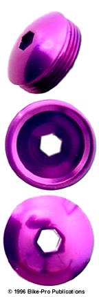

Picked up a Stumpjumper M2 frame with a pair of fairly worn Cook Bros cranks
Was in the process of removing cap on drive-side (pictured), had to apply a good bit of force (anti-clockwise), then very unpleasant feeling as the allen key completely gave way
As you can see, it's basically circular now
Anything I can do to get the crank off the bike? or will they be a permanent fixture now?

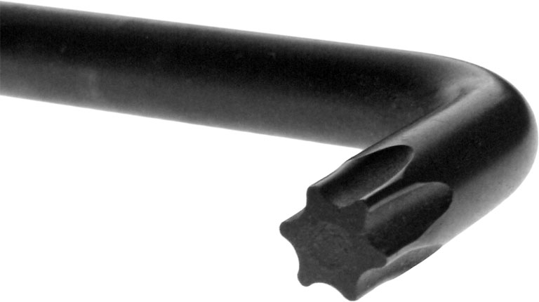

That cap is replacable. You could also try to hammer a torx in.

Thanks - I used a good size allen key, which went in very deep, which is why I am surprised it gave
Not to sound like a moron here, but is there any chance that these particular cranks open clockwise on the drive side?
I'd go with the torx approach. If you taper the ends of the splines a bit with a file then it will go nicely in. It also doesn't preclude using more invasive methods (such as dremel or easy out) later.
