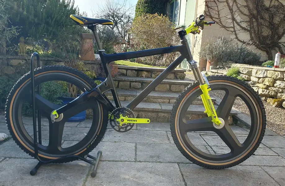

As the sun is still shining couldn't resist doing a test fit to see if I've got the Black/ Flouro ratio right. Still the Magura's to fit and would like some flouro bottle cages. The steerer definately needs shortning but happy so far

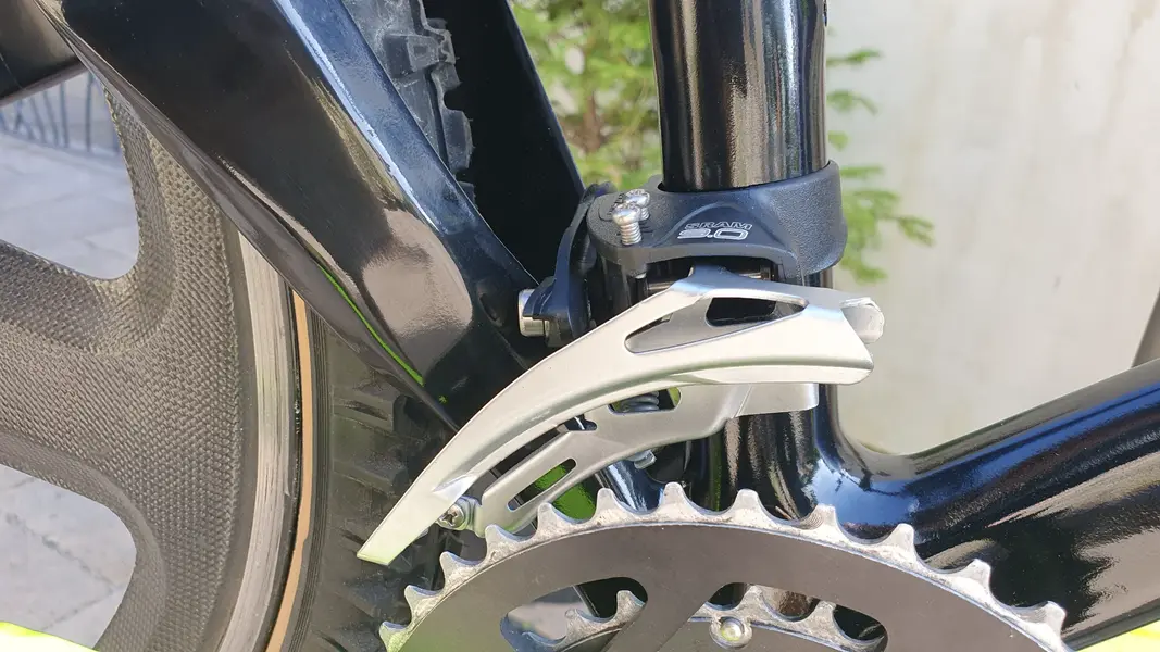

Bugger...the Sram 9.0 front derailleur doesn't fit due to the elevated chainstay due to it's low clamp design. I have a year correct XT m738 top pull which fits but it's really not doing it for me.
Any idea's for late 90's derailleur's that would go with the rest of the Sram 9.0 groupset? There are high clamp Sram's but can't see a 9.0 one
Omg I forgot about the exact same problem I had and the odd set up - I settled for the Shimano compromise but clearly with your level of pain tolerance and perseverance I’m expecting a brilliant if left field solution from yah!
