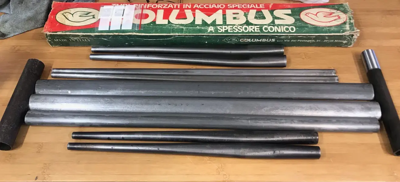

The machine was built by Argos & was a fixed based machine for a couple of years as Derek did get it converted to gears but preened never happy with gears. From when I knew him he raced on a huge 128” gear of a 57x12. He wanted an aero look so chose a full set of Columbus Air Mk.1 tubing set. So I knew in the current age this was going to be extremely hard to track down!!
But a project of this nature you have to be patient & luckily for me earlier this year a set came up & grabbed it straight away regardless of price as I know just how rare these things truly are.

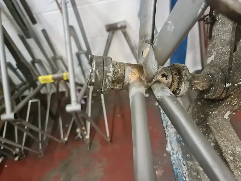

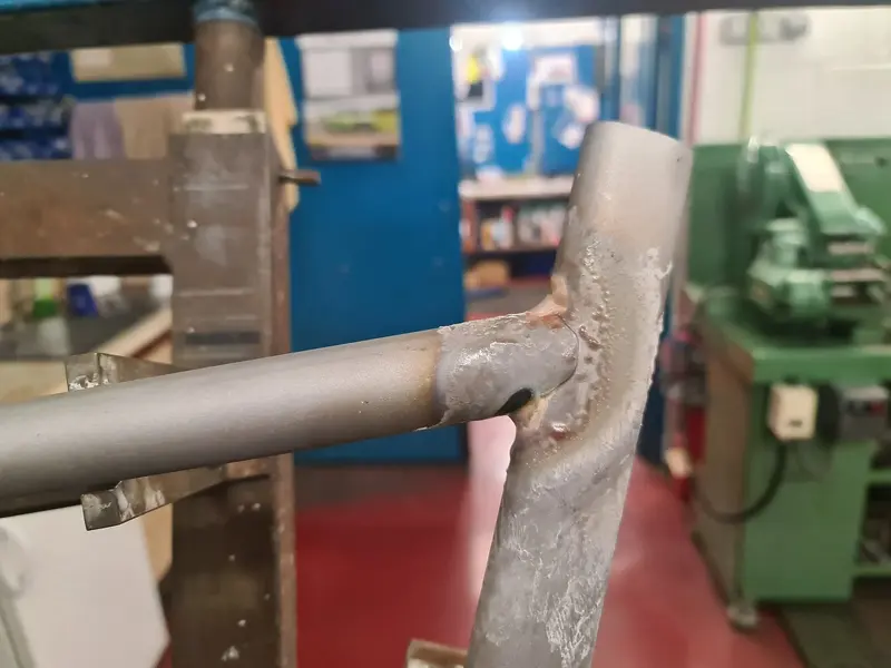

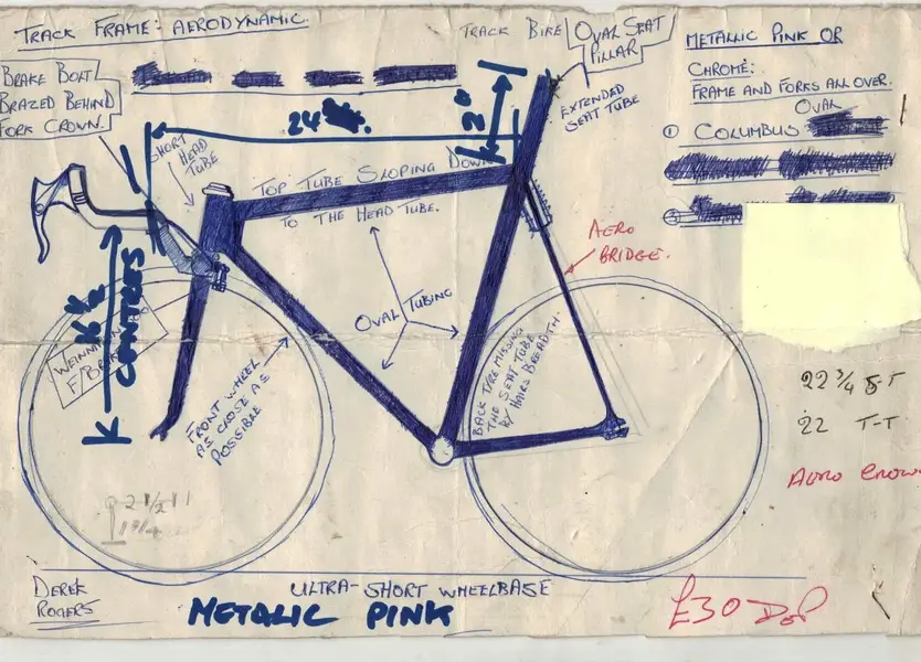

The project started back in February 2021 & I met up with the original frame builder Garry Needham son of the founder of Argos Arthur who I also met back in 80 & both are extremely knowledgeable on frame building etc.. I met Garry a couple of times to discuss the build & he found the original drawings & plans with Derek’s special requests so this replica frame was going to be an exact clone to the original having found a full set up the tubing.
Never seen before drawing made up by Derek himself when he discussed his requirements with Garry at Argos below
