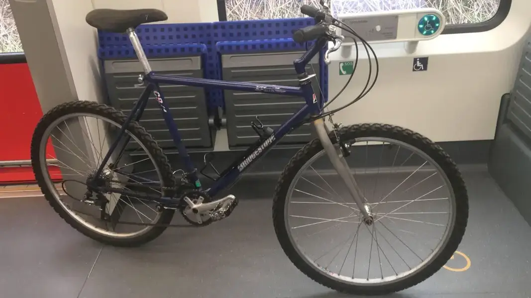

A Ritchey Timberwolf (very) unexpectedly showed up on the local CL a few weeks ago! No dents, but scratched, scraped, neglected, and generally just beat to shit. But the D-A hubs, 600 headset, and the BB were all good to rebuild! Deerhead F derailleurs never die, do they? Rims, rings, spokes, stem, and chain were ordered, the rest is parts bin stuff. The next owner can do a restoration. As it is, I think it will be a good bike for my screwed up neck. Took it for it's first ride out of the neighborhood this evening, tracks straight, smooth and quiet. Always kind of a relief to find out you didn't dump a bunch of $$ into something that's good for nothing other than photos on the interwebs. Lord knows I've been there... ;-)
Before and after...
