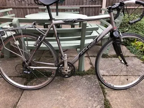

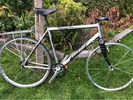

Hi
Just building a Marin north side trail for my winter road bike as I want to strip my summer bike, will be running 700c with schwable marathon plus tires 2x8 speed group set with v-brakes, have ordered the vbrake extension kit so that shouldn’t be a problem. Only issue I can see is the shifters using the road leavers with built in gear change anybody else had any issues. See picture below so far.

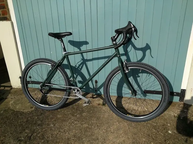

My '97 Marin Pine Mountain. Paintwork was in a mess so a quick respray was needed.
Oh - and single speed. 8)
Rolls well on the 2.25 tyres. I find the drops really help with the hills + single speed.
