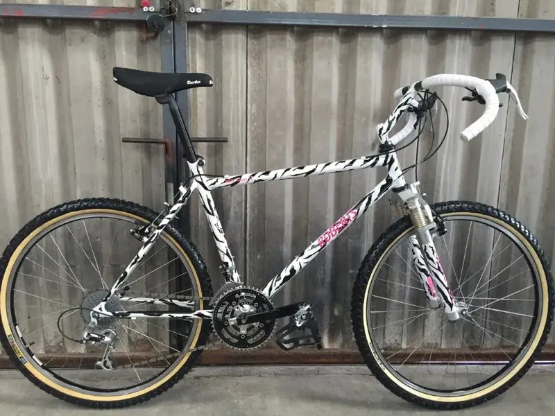

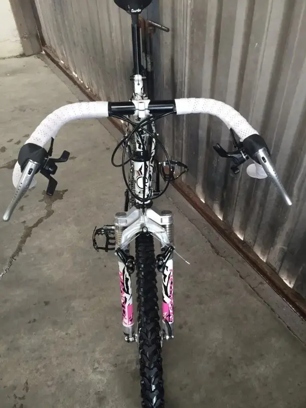

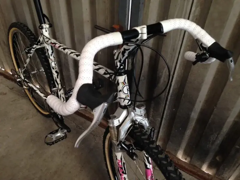

my attempt...
Obviously I don't know your vital statistics, but that looks a fair reach to yank on the brake levers.
Saddle looks rammmed back too.
Perhaps tilt the bars down so the bottoms are more horizontal and/or a steeper stem. When you get the bar height sorted tweaking the brake lever position for a easy grip is straight forward.
The saddle is half way on the rails, if not a little forward for me, top tube length is the shortest of all my White spiders, and considerably shorter than the Dogs Bollox.
I was careful sourcing the Salsa drop bar stem for my reach but I do think the brake/gear levers do need to come up the handlebar a smidge to be spot on for me, adjusting the saddle forward feels cramping for sure, the short reach flared bars are novel, hence the need to bring the levers up the bar, the angle of the brake/gear levers are totally alien compared to my drop bar experiences, but it less about the braking reach, that's fine, its the angle/height of the gearshifters I need closer.
Its just a shame its such ass ache to unravel all the bar tape for such a small tweek, but with new tape on the way, I hope it will make that difference.

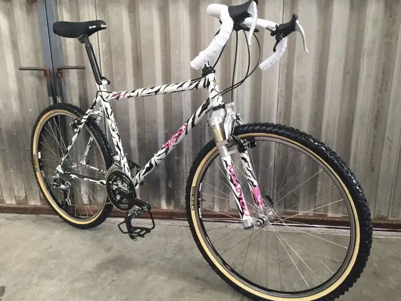

with all the above said and done, that's a std trail ride, and a small tweek that I'm sure will make the difference.
My burning question was and still is the performance and handling using the drop bar mated with the suspension fork, its fine on a trail, but until the replacement elastomers arrive and it gets a proper outing, I cant say if ive done the right thing not using a ridged fork.
Yeah, good question about the effect of any sag. About 2cm?
I think the main problem with DB conversions is nailing the reach to be in the hooks on a descent and being able to grab a fistfull of lever as easy with a flat bar.
Old drop bar levers and flared bars unfortunatly do not lend themselves well to riding on the hoods - more of an issue if you like bar ends on a flat bar.
