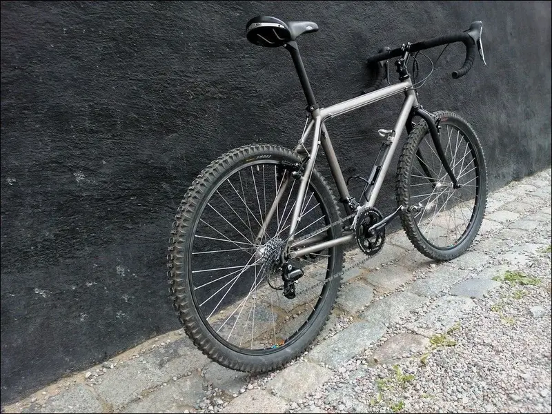

Well spotted and nice rig you got there Frantik.
For some reason there is a recent spate of modded DBR Axis TT for drop-bars and road use.

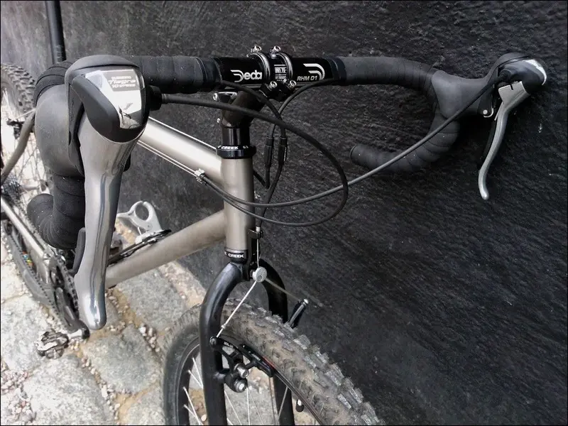

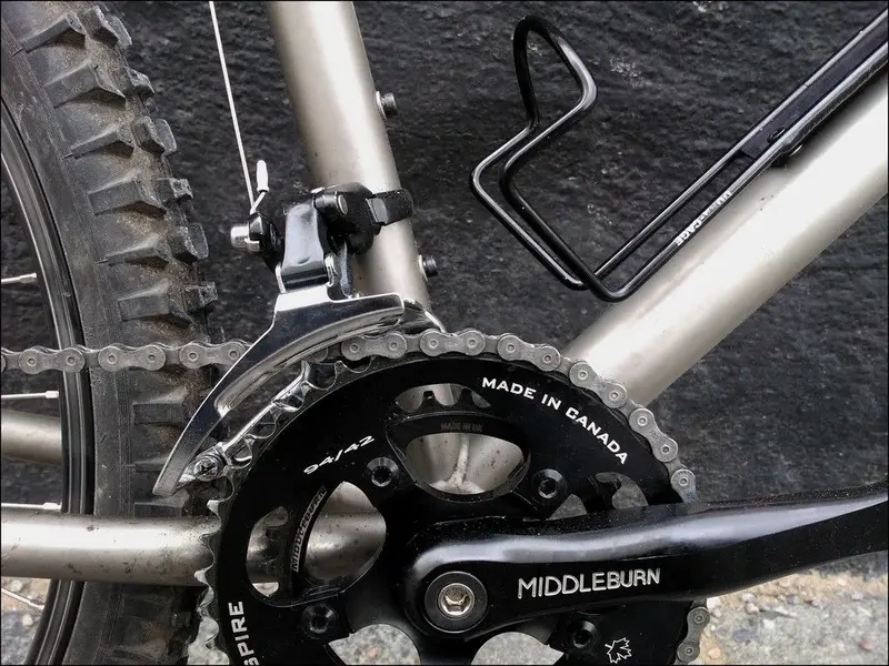

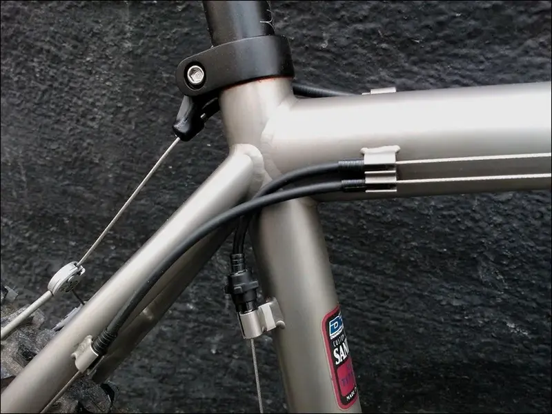

I'll throw in some more pictures too. The cockpit on mine is essentially modern using 3 x 10 brifters
with the alternative cable routing making it a 2 x 9. The original rear frame mounted canti-hanger was taken
off the DBR for another project so had to find a suitable solution to run cantis. Homemade FD cable adjuster
out of a an old rear mech to help tweak the front indexing (almost makes you think if DBR thought of putting
an adjuster on that strange protruding cable mount).
