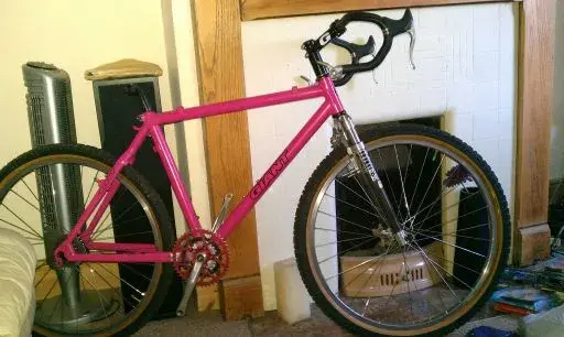

This thread inspired me to do this... Not finished yet but getting there.
