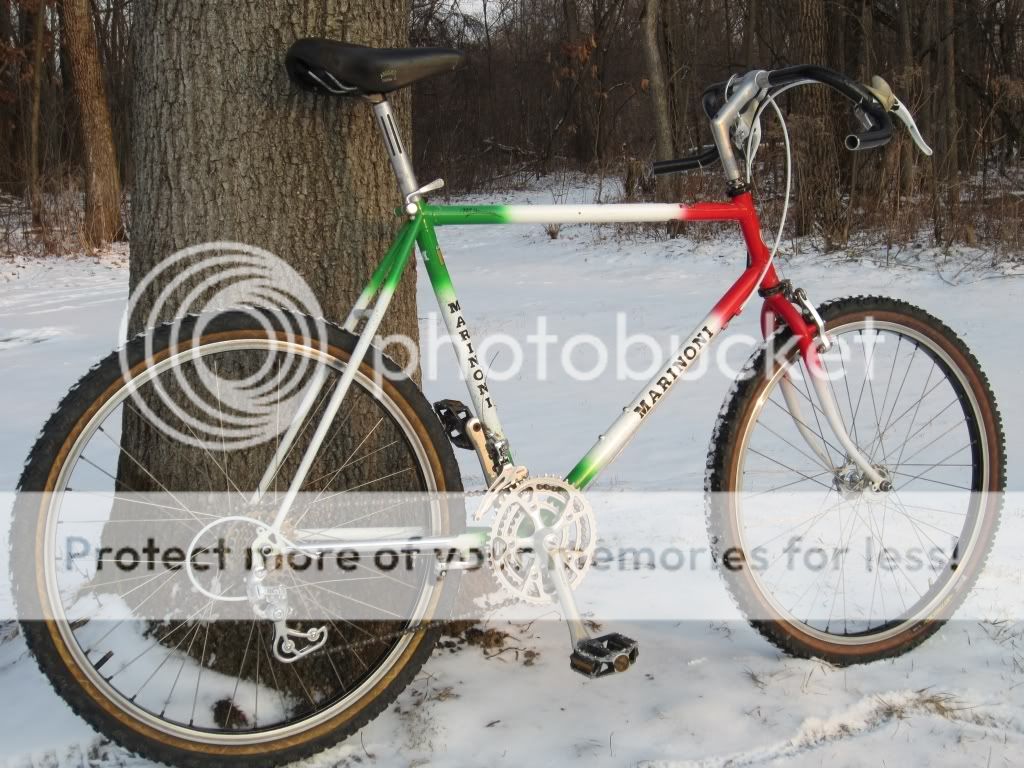

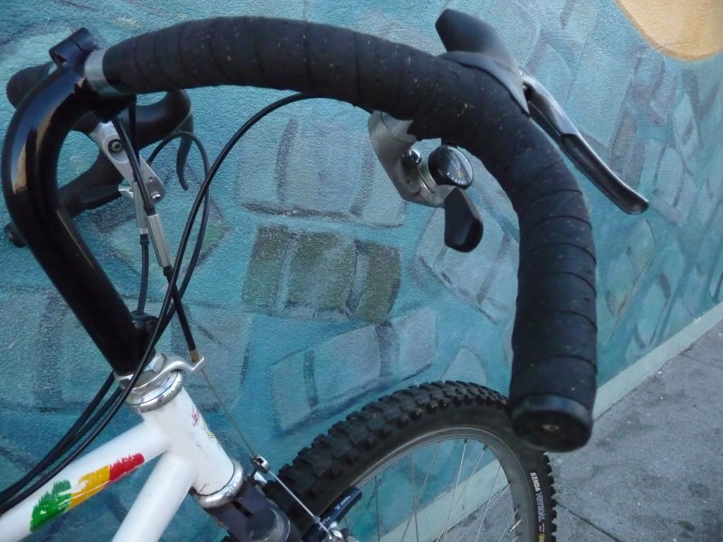

This is a 1985-ish Marinoni Moose that I've been building up with drop bars, took my second ride on it yesterday and nearly froze to death, but it's fun and works well. The build is still 'in progress' so no final tape on the bars and cables have not been cut to length, etc. The long wheelbase is very stable in the snow....it's a tank. Triple-pulley ARX rear derailleur requires a longer chain!

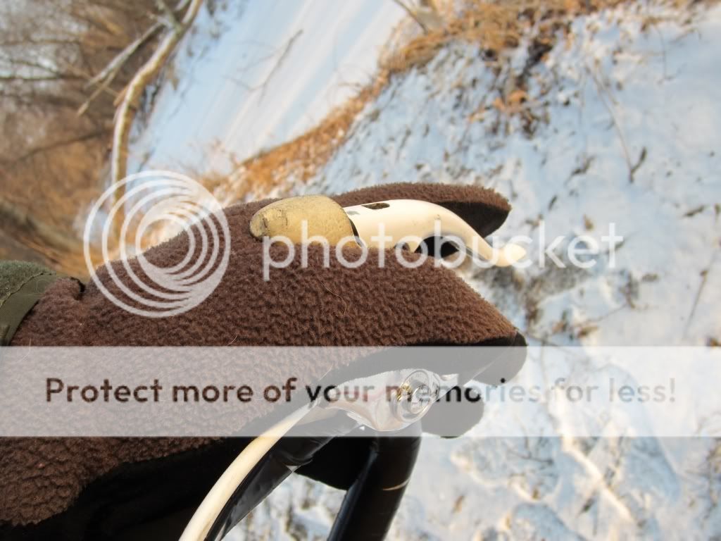

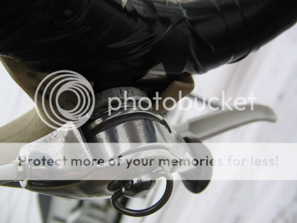

For shifting, I decided to reinvent the wheel. I wanted to use Suntour XC thumbies (that will be the primary build group on the bike), but I wanted them in the drops somehow. I ended up making my own bases and attaching them to the levers:
So far it's working better than expected, I still have some spacing issues to work out as the shift levers are somewhat in the way in the middle gears-the shifter body needs to move away from the brake body a couple more centimeters. I was surprised to find I can still ride on the hoods, my thumb follows the curve of the shifter perfectly. Rear shifting is stiff, I'll need to find a way to get friction out of the system somehow.
Front brake cable routing was an issue-I can't use a stem/headset cable stop (not enough steerer on the fork), so I adapted a V-brake noodle. Cable pull is smooth, no issues.
I need to spend more time in the saddle before I'm 100% sold on the riding position-right now it seems like the bars should be a bit higher. That's just fit though,the riding position is surprisingly natural, and it somehow doesn't feel like a road bike. I'm sold!

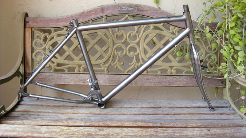

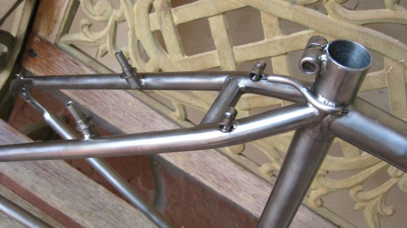

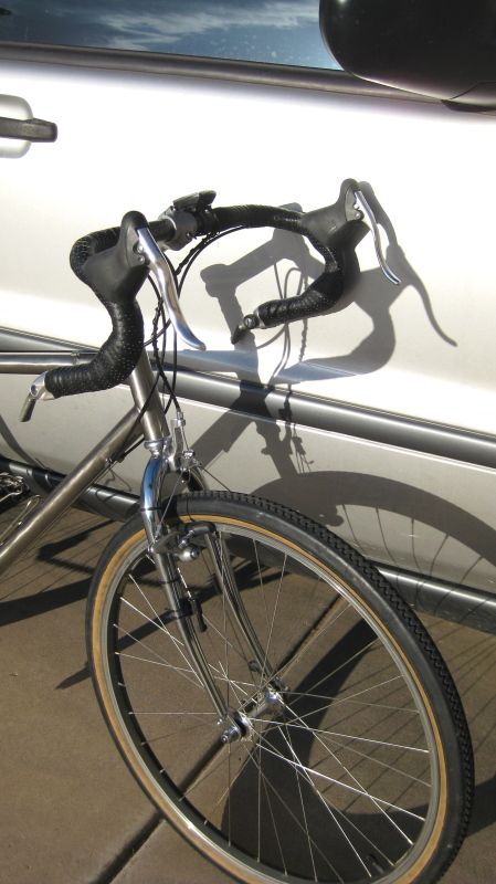

Ti Gravel Grinder at sunrise
Lately, I have been riding more, wrenching less, and practicing N-3+1. Here is +1.
I have been intrigued by some of the new "Gravel Grinders" on the market, particularly the Salsa Ti Vaya. So, before I dropped serious cash on the Vaya, I wanted to see what I could come up with. Besides, it's more fun that way and keeps me from engaging in antisocial behavior.

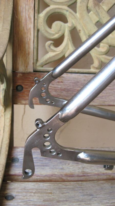

So, I began searching for just the right Ti MTB frame. For a drop bar setup, it needed to be a fairly large, older frame (shorter TT) built for a rigid fork (more HT). This really put me in the late 80's and early 90's (C&V).
I finally found the right frame -- a 1990 Russian frame manufactured for a Dutch bike company. The very kind and knowledgeable Dutch seller described the heritage to me as follows:
Many thanks for your shown interest ! A Dutchman ( Gijs van Tuyl) took up the idea to go east and have frames built from Russian army spec titanium. The early frames were also built at army facilities , I think this was near Novigrod. Later van Tuyl got EU money to start also other eatern Europe production facilities. Comparing the frame with other brands is difficult , I tried to make the description in the auction as honest and detailed as possible . In short: well built (good proportions , well welded) with many integrated details , the shaping of the tubes could have been better . The bike you built with this frame will be a good versitale ride.​

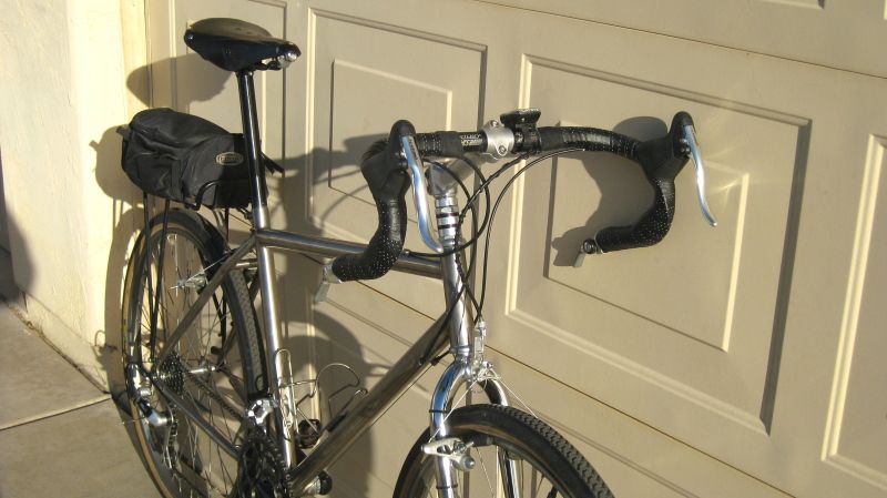

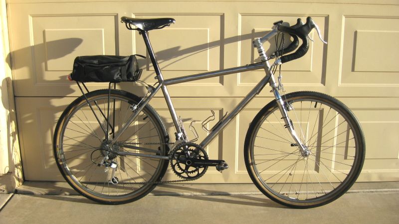

The frame arrived last week and I just finished the build. The components are a combination of old and new that I like and had around. The design is really function driven. My most specific design detail was to stick with the threaded fork so I could use a tall (VO) stem adapter with threadless stems. The combination of several inches of useful stem plus a choice of threadless stems of different lengths and angles gives me a great deal of fit flexibility for different conditions.
I am also considering whether it would be possible to convert the bike to 700 wheels so I could pool different wheel/tire/cassette combinations with my cyclocross bike.
Does anyone make long reach cantis that would work for the conversion or how about V-brakes.
At any rate, it's hit 60 degrees here and I'm out the door to grind.
Have a great weekend.
