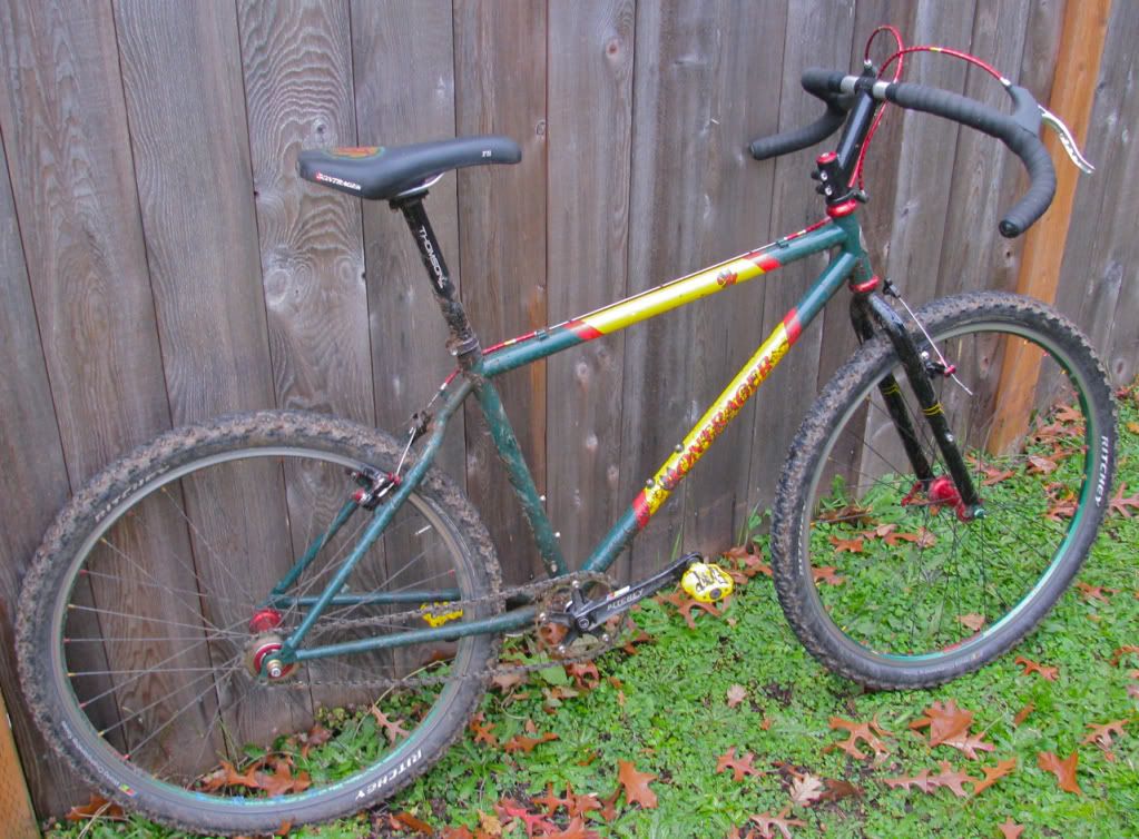

Ok not, fully dropped, (One One bars) but I love these, really aggressive riding position, great for climbing but a wee bit scary on steep downhills.
