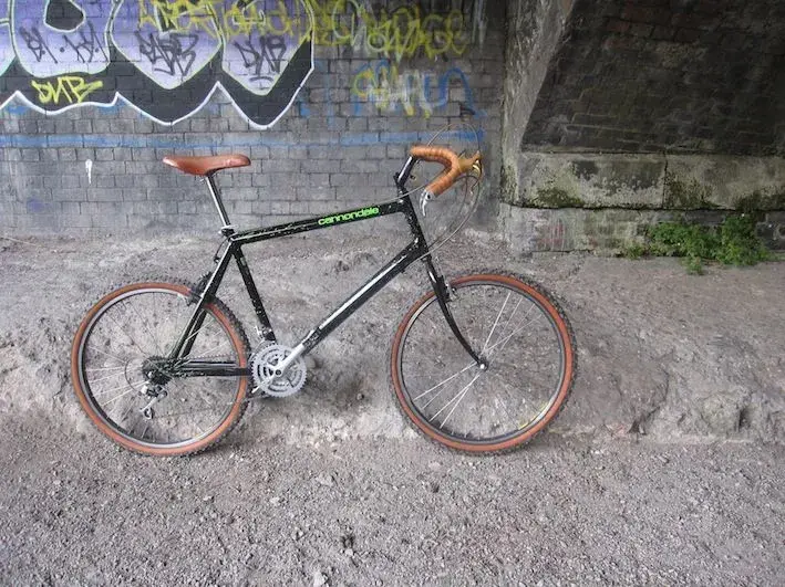

An update to my long running search for drop bar nirvana... the Overbury's build took a couple of years before the penny dropped (no pun intended) - that the frame was inappropriately short and squat (despite the high bottom bracket) for my project/physique... it remained languishing unridden in the cellar.
I then stumbled in a very clean and rather huge Dale frame sans fork and figured that the extra long head tube would give the WTBs a decent height with the few high rise stems available to me. Sure enough, the fit was an instant hit - the confidence to ride it properly was immediate and the traction/power generated through the position has all but negated my justifications for a crossbike this winter. Although I found a matching Pepperami (sic), I was dubious about the fragility/ride quality, so stuck with a Spinner up front, which I'm very happy with. The remaining itch is to try some Kelly Take-Offs I've had knocking about the cellar at some stage.
Celebrity rider EdEdwards had the temerity/honour to blood it whilst I manned the heckling tent decks, post-sunset at Mountain Mayhem this June and, even for such a curmudgeon, described it as 'alright' - praise indeed for one blessed with Tomac-like mad skills...
Larger pictures in my Gallery:
http://www.retrobike.co.uk/gallery2/mai ... =x4f4fa121
