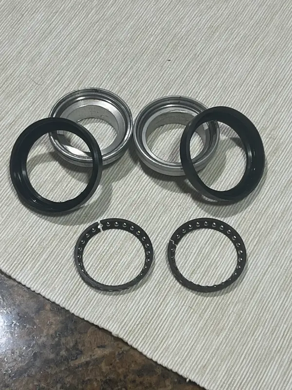

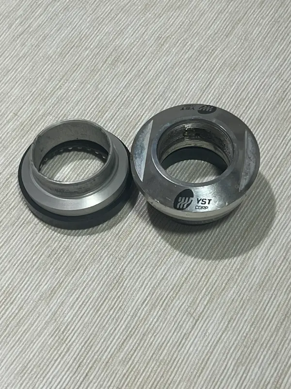

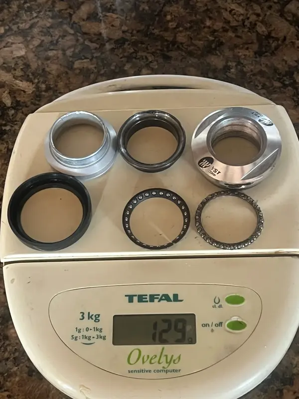

I took apart the headset to replace it with a higher-quality one. You know, it's a YST, and that sounds Taiwanese (boo!) Poor quality, not European, etc., etc., but doing so reminded me of something I've been keeping.

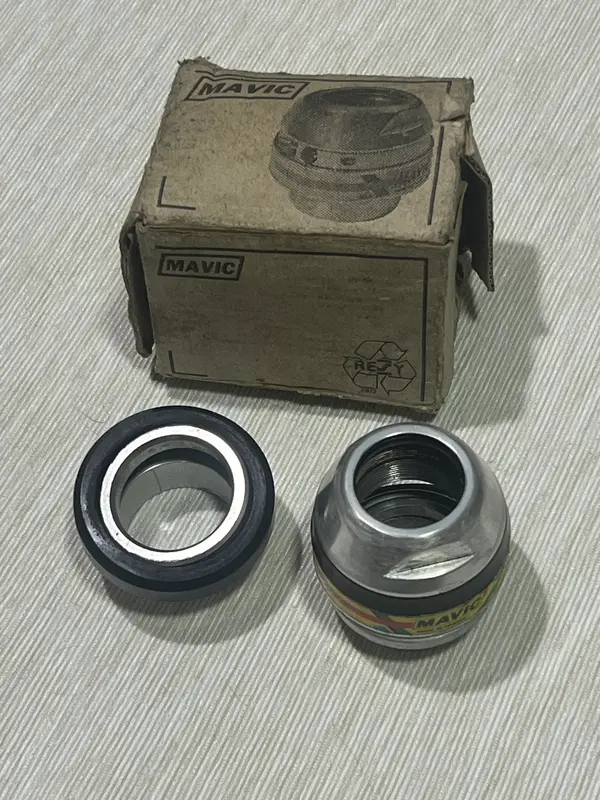

Yes, a 1 1/8 Mavic 316.
I went to look for it, and surprise! It's not that they look alike beyond their peculiar Allen screw-mounted upper cup attachment system; the ENTIRE lower part is the same. IT'S IDENTICAL.
And even more incredible, the YST is 1 1/4, but the lower dust cover fits both the 1 1/8 Mavic and the 1 1/4 YST. The same goes for the bearings; they're the same for both sizes!
The upper cups are already different, even in the positioning of the ball cages.
Anyway, YST may be more general-purpose than Mavic, but if I'm being CONSISTENT with my arguments, I can't change the YST for quality reasons; it's clearly the same or similar to the Mavic. I might change it for "prestige," "name," or because I'm a "snob," but not for the excuse of quality.
Besides, it feels very sturdy and lightweight, so I'd reinstall it (if I'd known, I'd save myself the trouble of disassembling it).

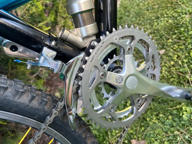

I have a Tioga MTB-SK bottom bracket with sealed NOS bearings tucked away in a corner. It's very sturdy with its sealed bearings, so I'll use it here.
A nice, robust-looking Sachs Quarz crankset with a 110 BCD allows me to maintain the essence of the "big" chainrings with a 48.
And of course, if we use the cranks, then we'll get to the rest of the build: Sachs Quarz rear and front derailleur.
Basically, the entire drivetrain is NOS. I must have really liked this bike to put such beautiful parts on it (I have a soft spot for Sachs, I don't use these parts lightly).

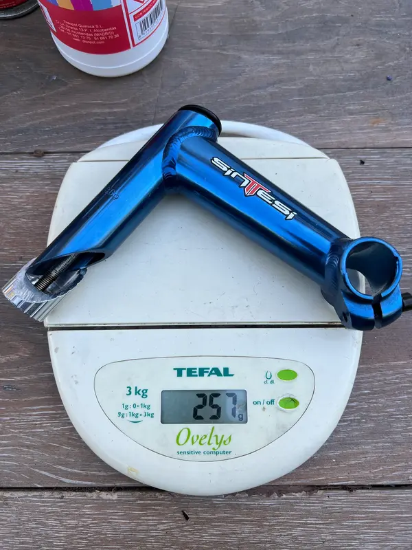

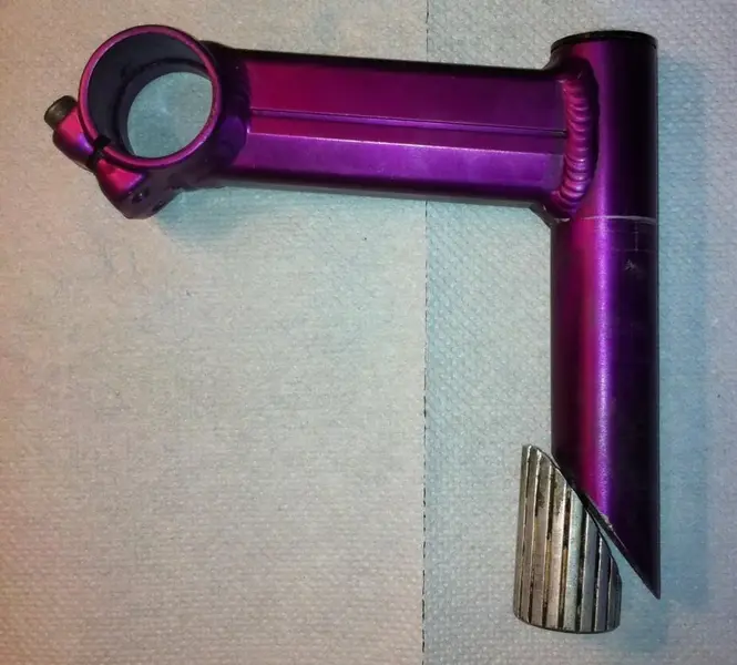

All that was left was to start looking for a suitable stem.
Sintesi offered great variety, and it was also important for them to give a coordinated look, just as seen in their catalogs.
Verlicchi also offered stems, but I've been looking and there are two problems: I can't find any in blue, and what I find would leave me hungry for six months.
So I'm discarding that idea and opting for another option.
I'm clear on the handlebars: I want a double riser.
I've never ridden one and I'm not sure what I'm thinking about it, so a very low rise and a modest width to start with are what I'm looking for.

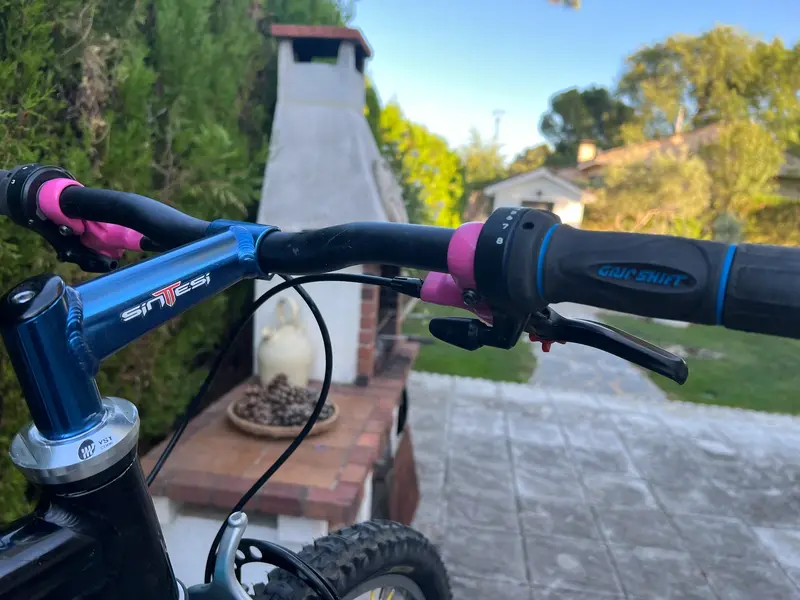

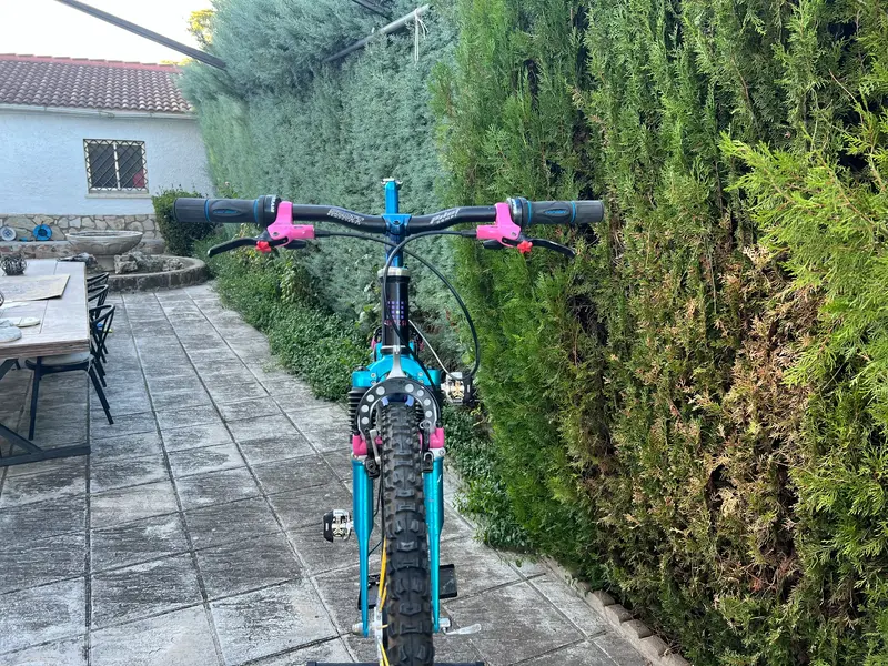

In the end, I found a black Scott handlebar, which I really like in contrast to the blue stem. It was also a 25.4, which I was also looking for to keep the bike as clean as possible. Well, Scott is a classic handlebar maker, and it's very well done.
So now I can start building the bike! I was craving some Shift half-pipe grips, because I remember that when they came out, Sram advertised them as better for downhill due to their better control... what a failure, haha.
In any case, I want the half-pipes, and I found these in blue at the end of my garage in a yellow bag (where did they come from? Mystery).
A sturdy Sachs chain to finish off the set.

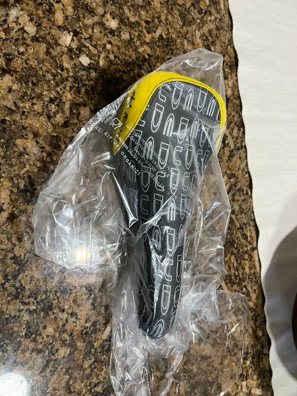

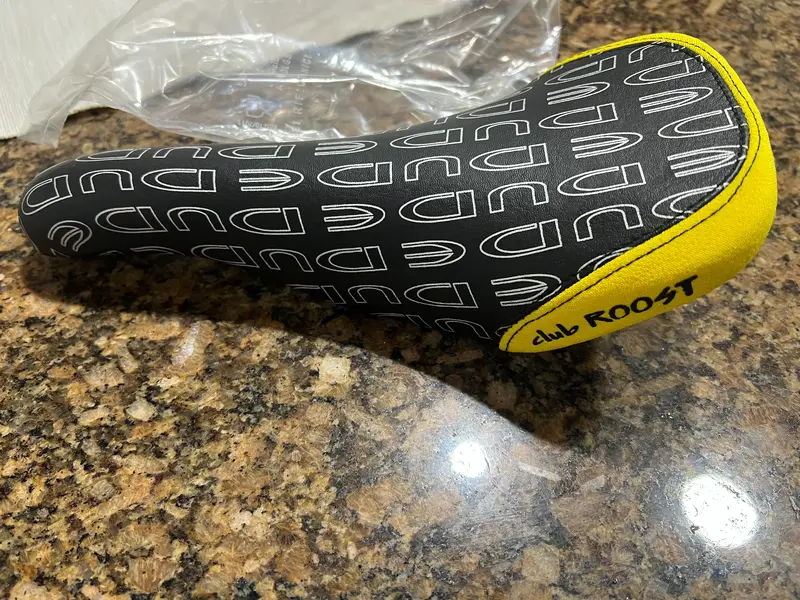

And I was already looking for a saddle to finish off the bike.
I repeat, I'm not very familiar with the downhill world, and therefore, neither are I familiar with specific saddles, except for Tioga and a few others.
Of course, I wasn't looking for a downhill focus, more like freeride or enduro.
And then a Club Roost Dude appeared, black with yellow Kevlar sides like the wheel spokes.
And brand new too... I went for it!
Well, it's what I wanted, I really like it.
