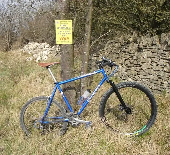

Ahem..

:shock: Is this 29/26? It looks biiiiiiiig on the front. How does it ride? And how are you riding it? Those bars look relaxed (unless that's a perspective thing), but you've got the nobbles on?! Do you have an off-road commute, or is there something else happening here?
