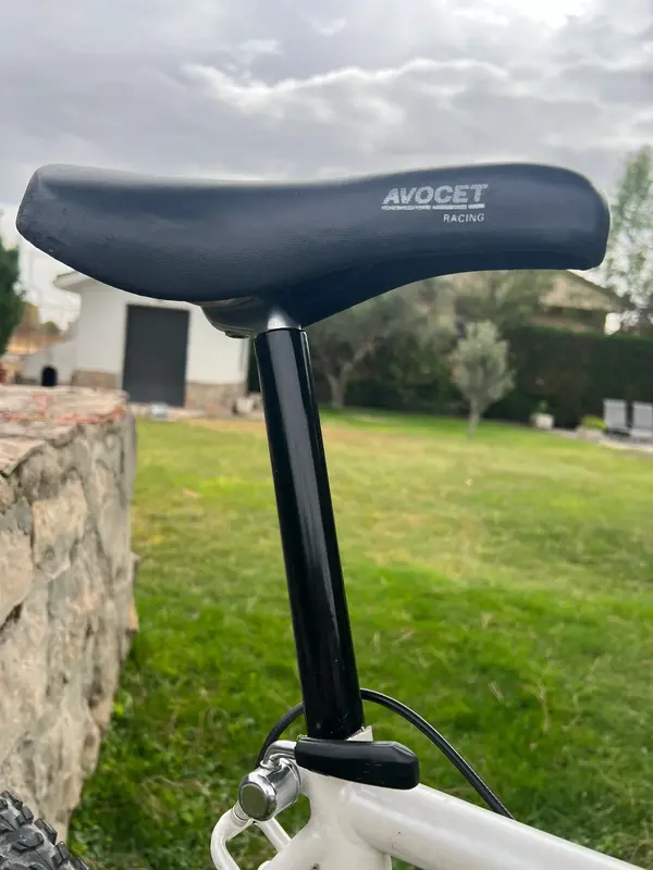

Funny it has 4 finger XT brake levers fitted. What was the saddle that was fitted when you bought it as they were own branded? The original seatposts were Strong Japan branded. Looks in great condition. The original tyres I think were MS Racing branded and are crazy rare.

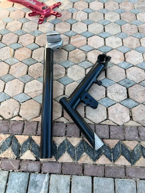

I also picked up the powder-coated stem and seatpost.
I think the idea of leaving the seatpost head in its natural color turned out well.
And seeing it, I remembered why I wanted to paint it that way (it was something that was in my subconscious and I couldn't identify before): it reminds me of the Mavic seatpost. 😁😁
