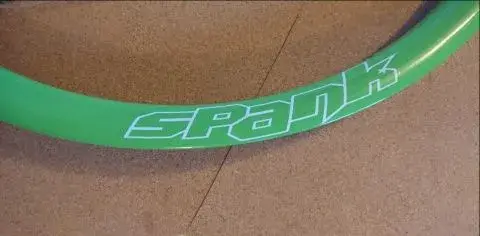

Impulsive and possibly ill-thought-out buying has happened :D details to follow once they arrive but for now let’s say we are using 32H rims which won’t support a rim brake
Not 100% on these, heck I'm barely 50%, but hey, sometimes you just got to roll with it.
Not super light but lighter than many. Colour is, well, colourful and plays nicely with the pink frame. And they were a fricking steal.

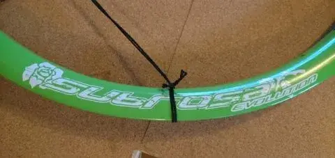

Some rims in the box now and a choice of hubs so making good progress in the wheel department.
Or is it?
Black hubs because nice and tidy plus black forks, green rims because why not. Can’t decide whether to use silver spokes or whether I should go for black there too. Hmmm, that’s such a little problem I can barely type it out.

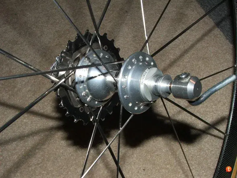

Moving on from colour onto patterns and numbers of spokes, I have seen some interesting threads around the web about lacing 32H hubs / rims with 16 spokes. Certainly for the front wheel there seems to be a reasonable case for saving a bit of weight by dropping the spoke count. It’s a small diameter wheel and the rim is strong so don’t have to worry too much about flexing all over the place, and no rim brake to worry about even if it is a little flexy. Plus remember we are talking about a kids bike here so light weight rider, light use.
couple of examples stolen from the web:
Advice seems to be that a crossed pattern rather than radial is essential but beyond that theres lots of guesswork and reckoning.
Never done it before but I’d be interested to hear any experiences along these lines.

thinking about this again.
say 6g per spoke x16 spokes is around 100g of weight from the front wheel. That's not bad.
Doing this with the front wheel should be fine but advice (chatter on the web) for doing so with the rear wheel is a bit less convincing.
Anyone here tried this?

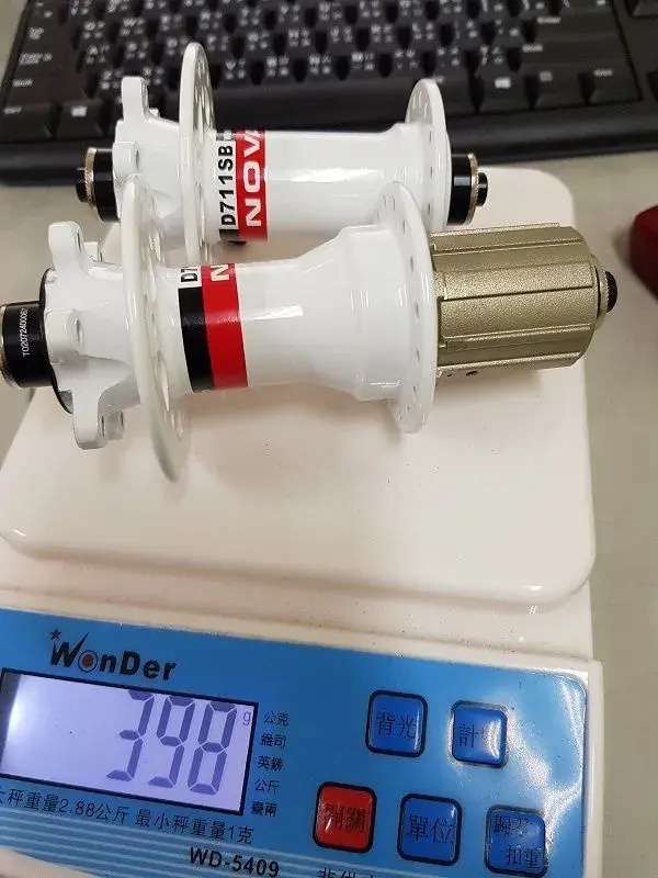

photo is nicked from the web but I bagged a pair of these lightweight Novatec hubs for a good price.
They certainly tick the weight box but I got them in white, so not quite ticking the optional 'black' box. Given the intended use I can't imagine that these won't be up to the job strength or durability wise.
~400g for the pair is pretty weenie for disc hubs, even lighter than Hope Pro 2's and a fraction of the cost. I'll give them a once over when they finally arrive but thats now a fourth option in the bag - these (398g), Ringle Disc Jockey (644g), Shimano XT 756 (663g) or Hope XC (590g).
I reckon the Novatec hubs and Spank rims (maybe with 16 spokes, still thinking on that one) should bring the bare wheelset in around 1.5kg, so some lightweight tyres should allow a sub-3kg wheelset, maybe a bit over once a cassette is added.

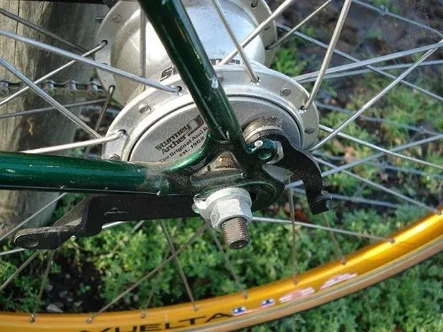

Just got my hands on Plan B in the shape of a pair of Sturmey Archer 8 speed drum brake hubs.
Well, I say got my hands on, just sorting out delivery now :?
the spanner in the works being these are currently laced to 700C rims with 36 spokes and I want to pop them on 24" rims using 32 spokes :facepalm: guess Plan B would be involving a change of rim too then.
But before all that I want to try them out and see if they work, and establish whether what looks like a fair weight penalty is the way to go.
