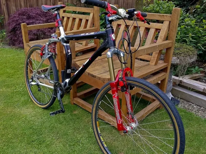

my single speed road transport built from repaired frame (just above bb )
have 2 other sts in the build process and will post pics at later date
magura hoses need cutting an fitted through frame guides n new pads for ceramic (nos hs33 straight out of box )

Nice! Colours work well. What tyres are they?
