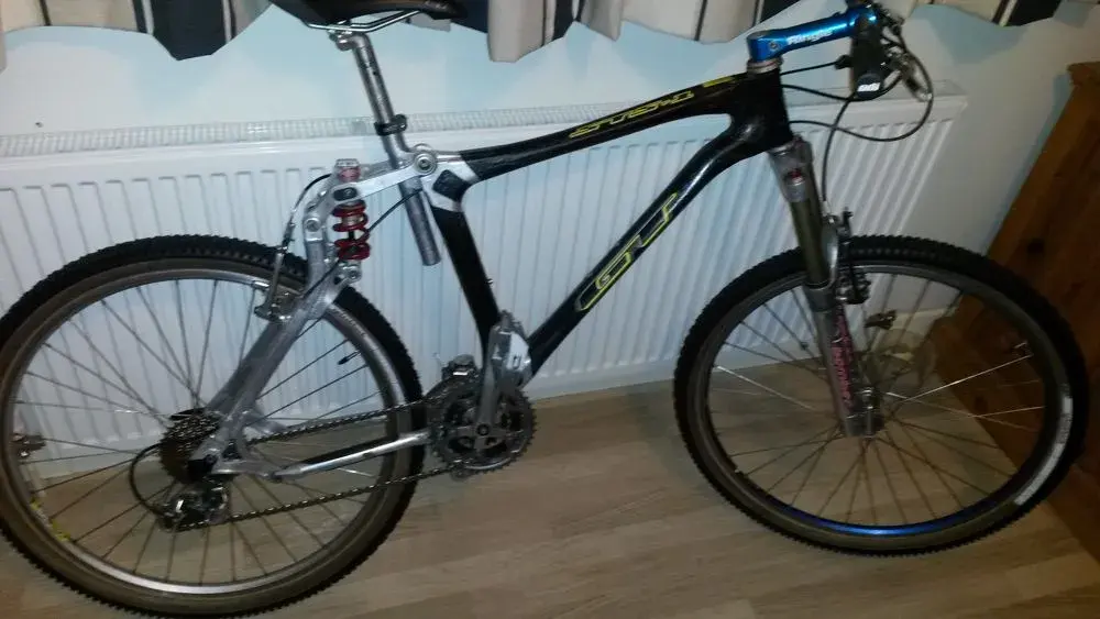

Hi All
Have finally got my STS-1 built up, but found an interesting issue. When I actually sit on the bike it seems to shift the gears at the back. Essentially the shifter can be on the biggest cog at the back, yet the rear mech is on the smallest cog.
What is happening? Is it that the cables are too short (maybe the linking outer between the frame and the rear triangle)?
If it is cables how do I go about changing them over without losing the cable routing?
Will post up pics when done, but it is no where near as nice as a load on here.
Cheers
Graham

@Graham: It sounds like a gear cable issue, but put some pics please. Does the cabe routing look like similar to mine?
Will try to get some pics up. My rear cable is way tighter between the frame and the swingarm.
I have a suspicion it might be that the section of outer is too short.
Mine has got internal routing.
Will try to post up a pic in a sec
Apologies for the crap focus on the bike.
Phone camera isn't that good, and the thought of cropping a dslr pic down to fit on here was more annoyance than I could deal with tonight

Yes, I think the problem is that you don't have enough slack in your cable/housing and when you compress the rear suspension by sitting on the bike, it affects to the lenght of the cable housing and by that to the rear derailleur adjustment.
- cable hosing to short
- chain is to long
- the back of the bike stands to high
