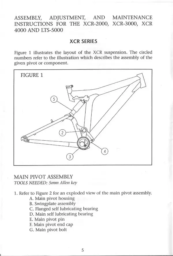

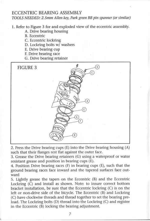

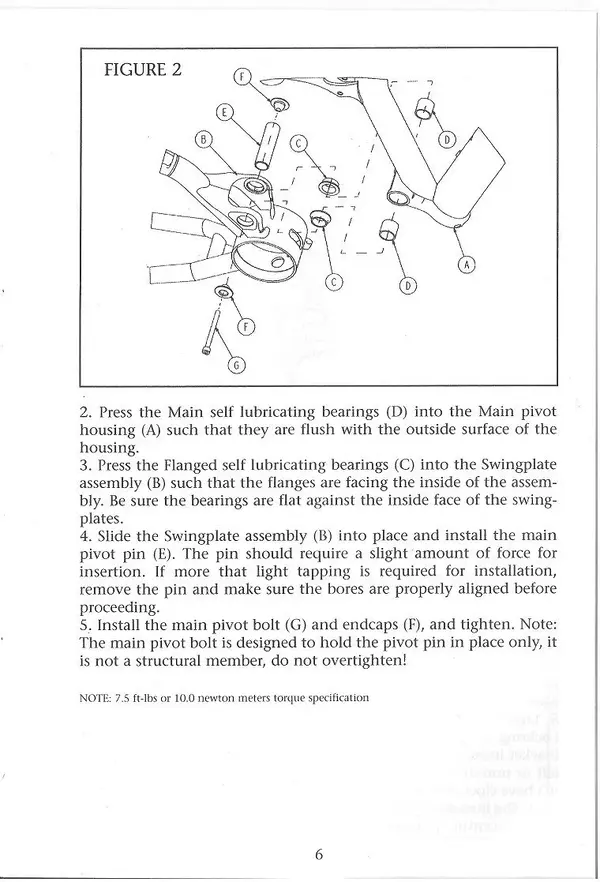

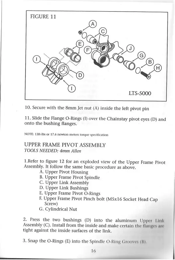

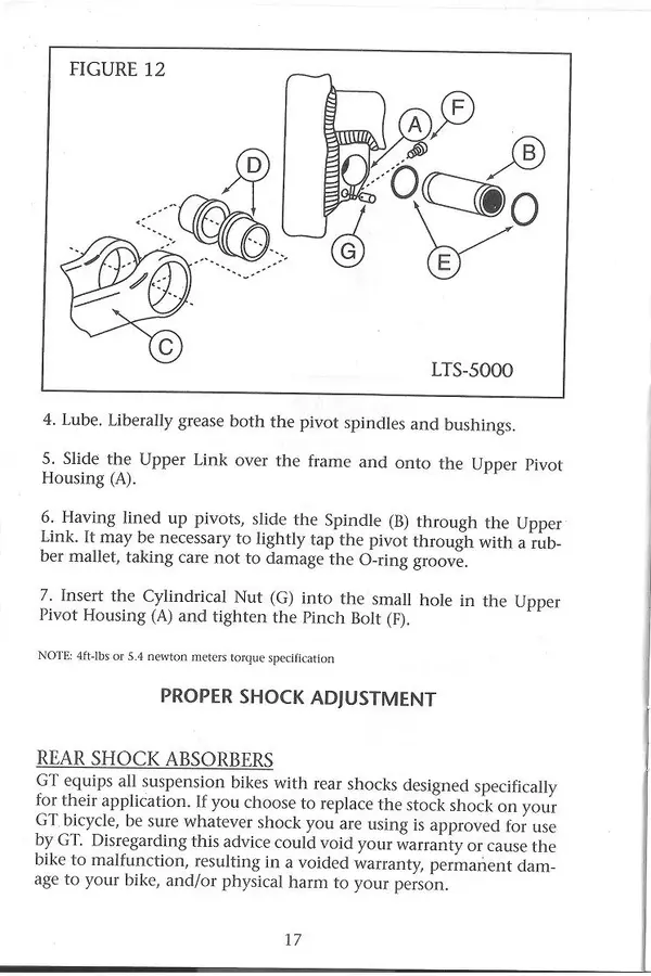

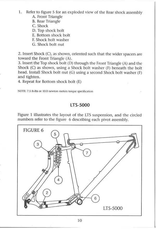

GT Later LTS / XCR / i-drive suspension supplement

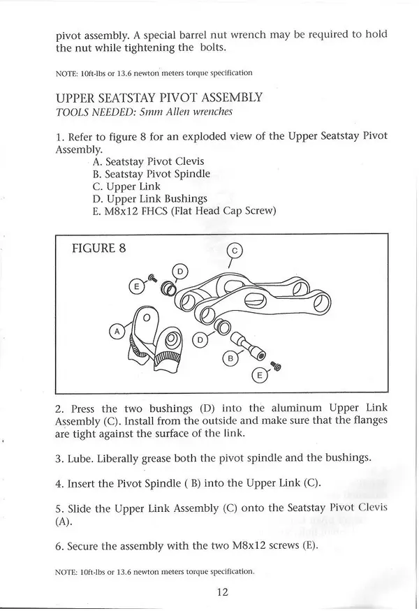

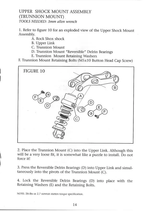

In the past, there's been a few threads asking for help with assembly and maintenance of XCR rear ends.
Here is the GT suspension supplement for later LTS / XCR / i-drive models for reference:

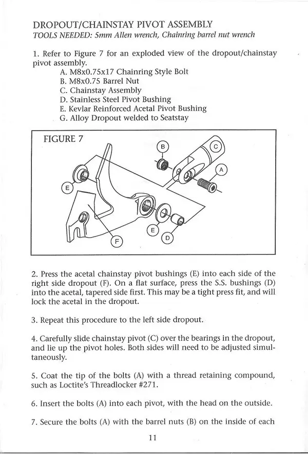

GT Later LTS / XCR / Idrive suspension supplement
part 2:

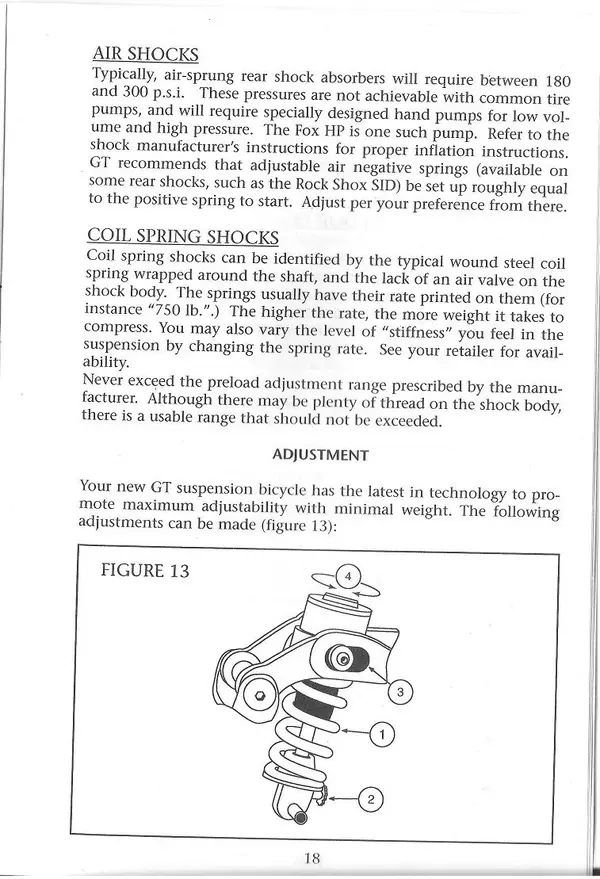

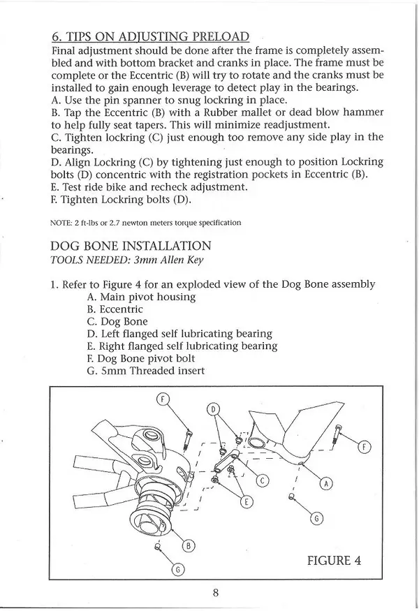

part 4:
