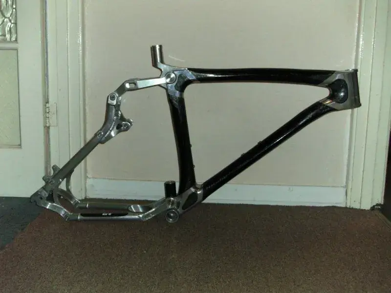

Just add my STS here, frame number 099603131 18

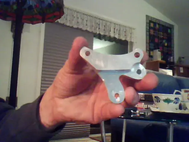

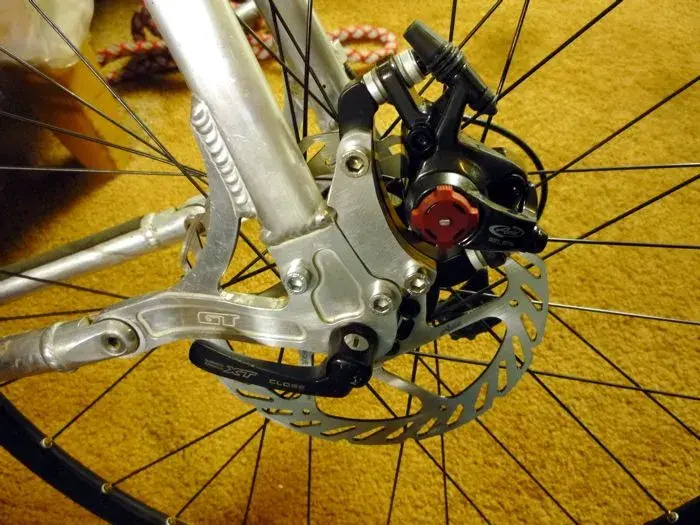

I've just finished a rear disc mount for my STS-1000. I fabricated it from a chunk of aluminum from the local scrap yard. Sorry for the lousy web cam pic... I'll take a proper photo once it's installed.
My Super Deluxe started leaking oil, so I'm replacing it with a Fox Float. My friend is machining a mount for it, and I'll post pics of that when it's done.
Soon I'll have the bike trail-worthy... though I feel a little guilty for not keeping it original.

Re: STS rear disc mount
Cool, i always like homemade mods, keeps us informed of progress, BETD do a similar adapter, for about 25 quid
That's $37.75 to me, plus shipping. Like I said in an earlier post, I'm a cheapskate. I'm also a DIY kind of guy.
Will post further mods (though I think I'll be pretty much done after the shock mount).

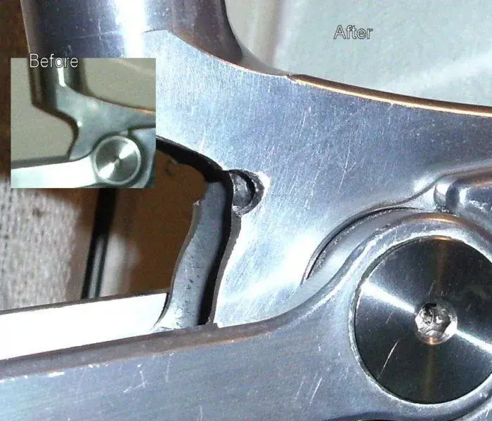

After noticing 2 tiny cracks on the outside of the seat post area, right next to where the cables came out, I filed them out, welding a couple of blobs of weld onto the areas had crossed my mind, but i dont have access to a welder.
the inserted before picture, just about shows where the aluminium was pushed out (just catching the flash), from what i have deduced as being down to the outer cables pressing against the thin surroundings, caused by the seatpost. The aluminium wasnt at all cracked/damaged the other side, so i think i have happy that it was purely down to the cables, also now with a seatpost in, the cables are freely able to move in and out of the holes.
Obviously one concern is that i have weakened the structure, but honestly cant see this being a problem.

Whilst not being an engineer, it looks to be enough material to not affect structural integrity. Just make sure you have no hairline cracks or sharp edges in the area you have filed up, or that might be a source of a new crack developing. Maybe use very fine grain sandpaper to sand down the edge as it still looks rather rough to me. That would lessen the concern.
Yes that is the next thing to do, is fully smooth it, i was just using the round file i had to hand.
