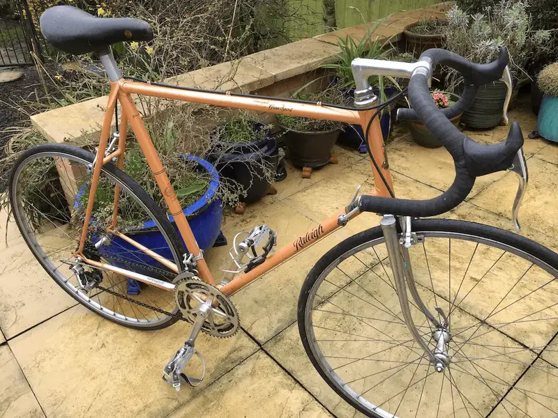

The faded Caramel beast......'82 Raleigh Gran Sport
You can see all placements on this one.
Cheers guys. Got a spare heron sticker for one of my Raleigh roadsters then! One other thing I noticed in fitting them is the "gran sport" script at the top of the seat tube is too big on mine.
