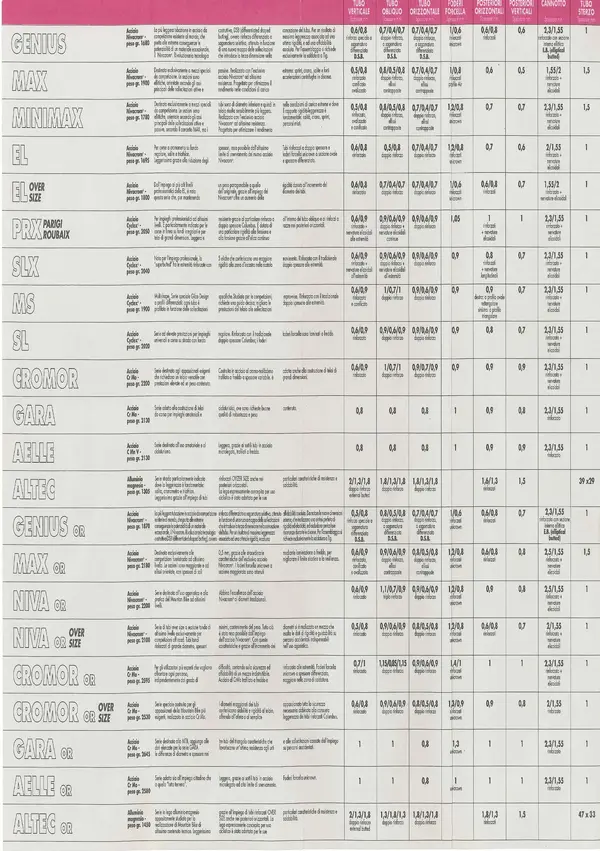

Well, I am attaching images of the catalog of the original genius OR series that was included when purchasing the tubes, in case it may be interesting.
I also attach the one I have from '95 where they call it Genius MTB and the complete series weighs more.
It doesn't appear in the 2000 catalog, so I don't include it, but it does include a complete description of the Nemo series, which is interesting, I think it was Columbus' last great steel pipe. I had one, very light although the fork not so much Imagen24.webp catalogo Columbus.webp

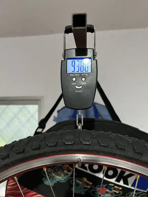

I have weighed it. He has gained some but is still below 9.4 kg.

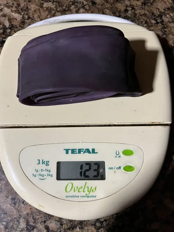

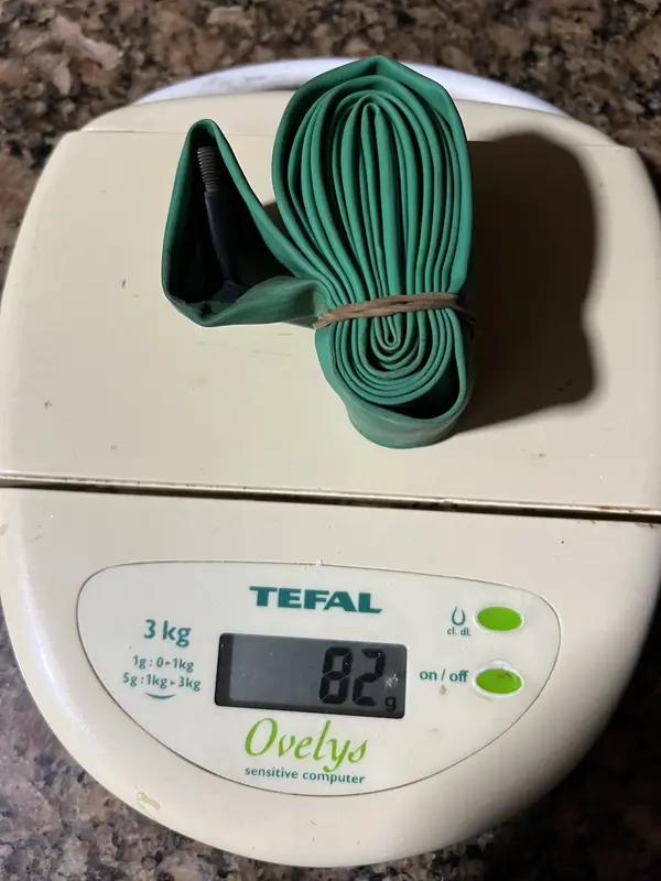

I had to change the latex Vittoria inner tube because the fans would burst. It has happened to me on an ATX 800 and now on this one. It's a shame, I have several Vittoria inner tubes in latex but I can't use them anymore, just keep them as a souvenir. I also had 2 latex from Dt Swiss. They were spectacular in weight, but I will also keep them as a souvenir. I have put Michelin. Yeah! The inner tubes are also European.

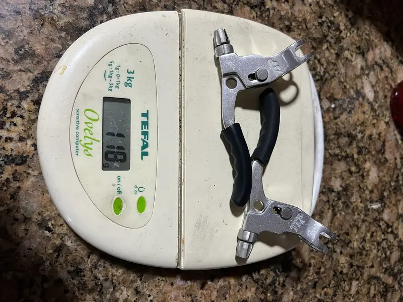

With the handlebars however I have gained about 20 gr. Something is something, Jjjjj

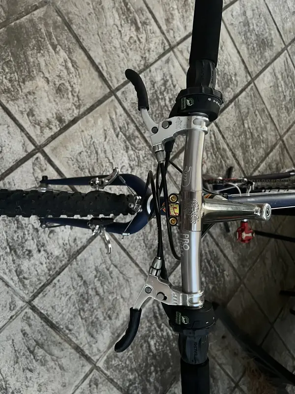

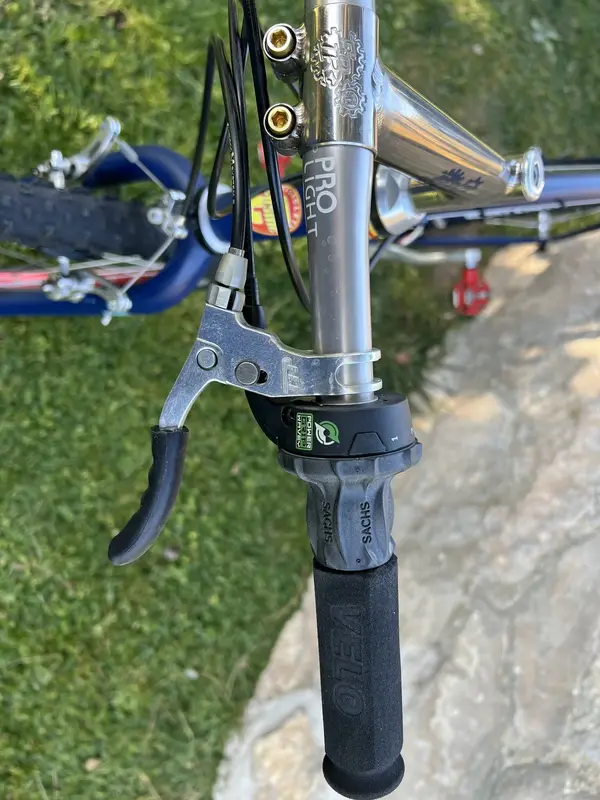

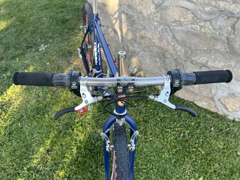

I got the brake levers before summer.

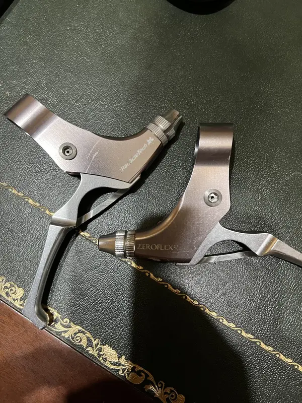

I was tired of searching and not finding anything I liked and decided to change my strategy:
I thought that whoever had some emblematic levers of the time did not need to sell them but they would still exchange them for other interesting ones.
So I offered some Machine Tech Zero Flex that I had and got an exchange with a lover and great master of classic bicycles: Some beautiful Spanish TTP
Yes, they are a Grafton replica :LOL: :LOL:
Soon I think I will be able to put some light grip foam on them more to my liking.
But for now they are here

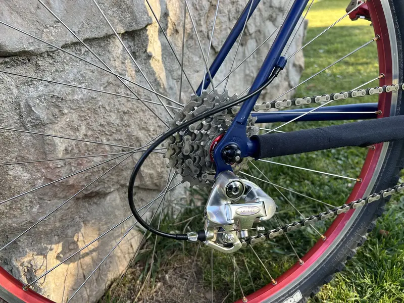

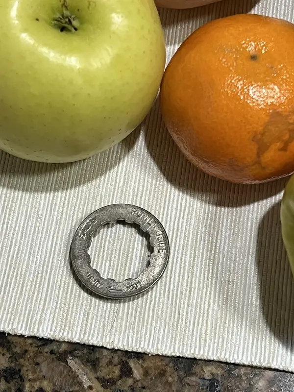

The cassette had to be an 11/28
My rear derailleur has a short case and does not allow further development.
I found several Sachs PowerGlides in 11/32 but they were not suitable
So I thought about a Miche and even ordered one, but they didn't have that development at the time and they had to order it...and that was a plus!
I discussed the matter with another classic bike enthusiast and he had a unit in 11/28 PowerGlide!!!!!
A change for a mavic 517 and the matter resolved after a very long time :LOL::LOL::LOL:
The solution was as simple as asking for help, what a shame about lost years.

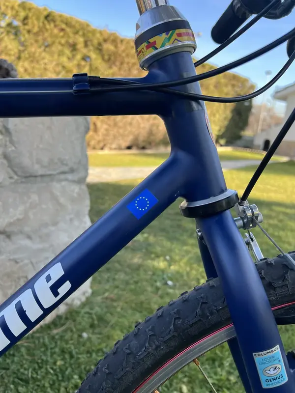

A few small decals on the down tube to commemorate this issue with the European stars and that's it for now.
For now...
The largest rear sprocket is affected by the derailleur parallelogram angle, which is usually the same, short, med or long cage.
The total capacity (i.e. big+big minus small+small) is what the cage length dictates.
Assuming the derailleur model accepts a 32 rear sprocket, slightly closer sprocket sizes on the front would reduce the required capacity.
I can't see which derailleur you are using, but a sachs quartz will do 32 max on all cage lengths.
You could use aerothan thermoplastic tubes from schwalbe, save over 100g on both wheels.
They are more reliable than latex, but seem more prone to puncture.
