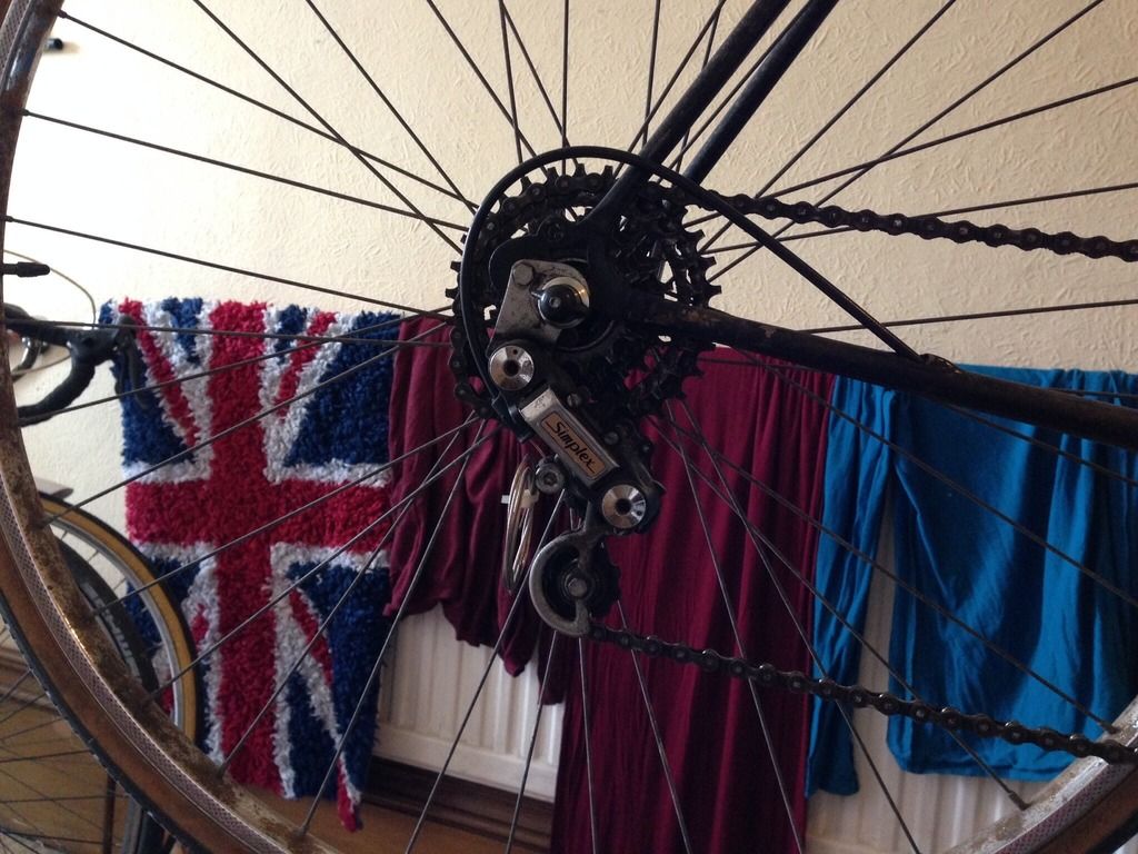

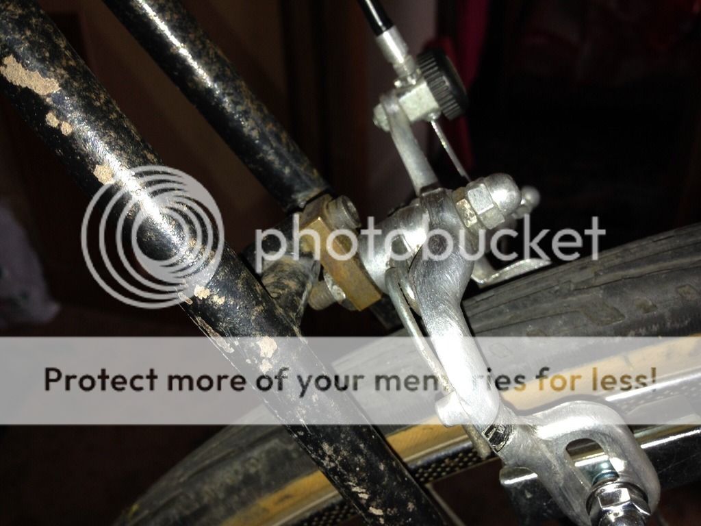

Finally a bike came up with a single photo which must of been shot with a potato! But I thought it was worth going to see as it was close by and it had no bids so off I went and what was there was a bit rough around the edges to say the least! But the wheels were true and the gears and the brakes worked so for £20 I whisked it away without even worrying what it looked like I thought it would do a job.

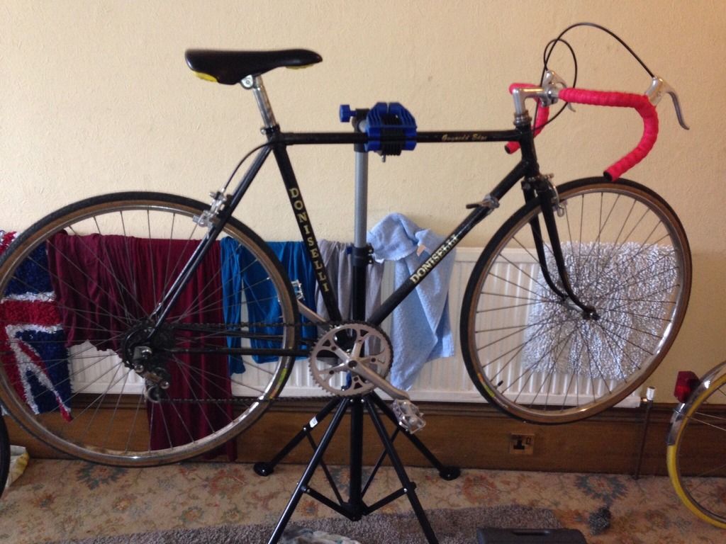

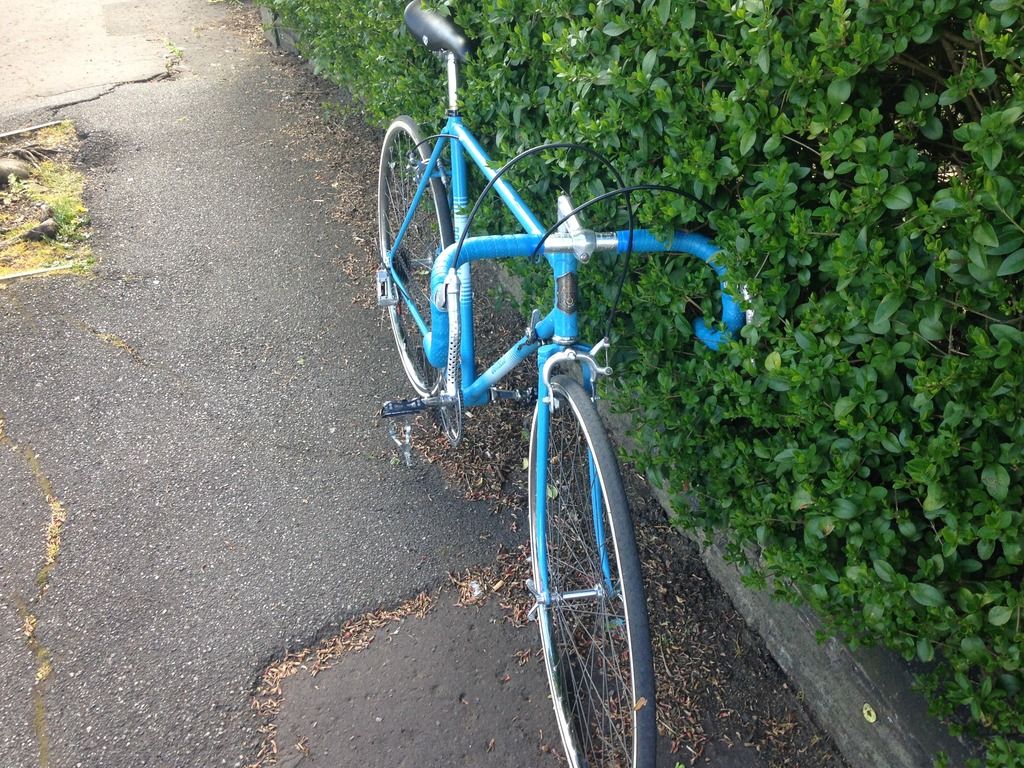

So here is how the bike looked when I first got it! Excuse the washing in the hall :D
Looking back it was pretty bad but it worked and for about a month I was content with it. After that I got the bug and things escalated quickly.
So a month had past and the bike had not set a foot wrong but I thought it was worth giving everything a service and actually finding out what I had bought.

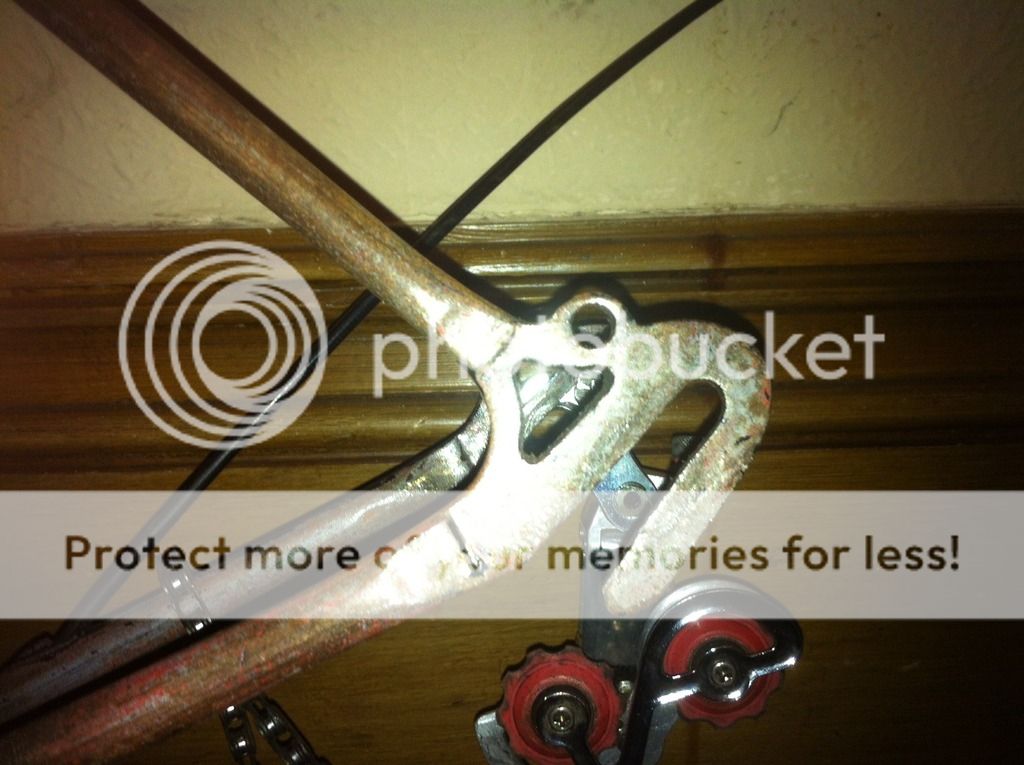

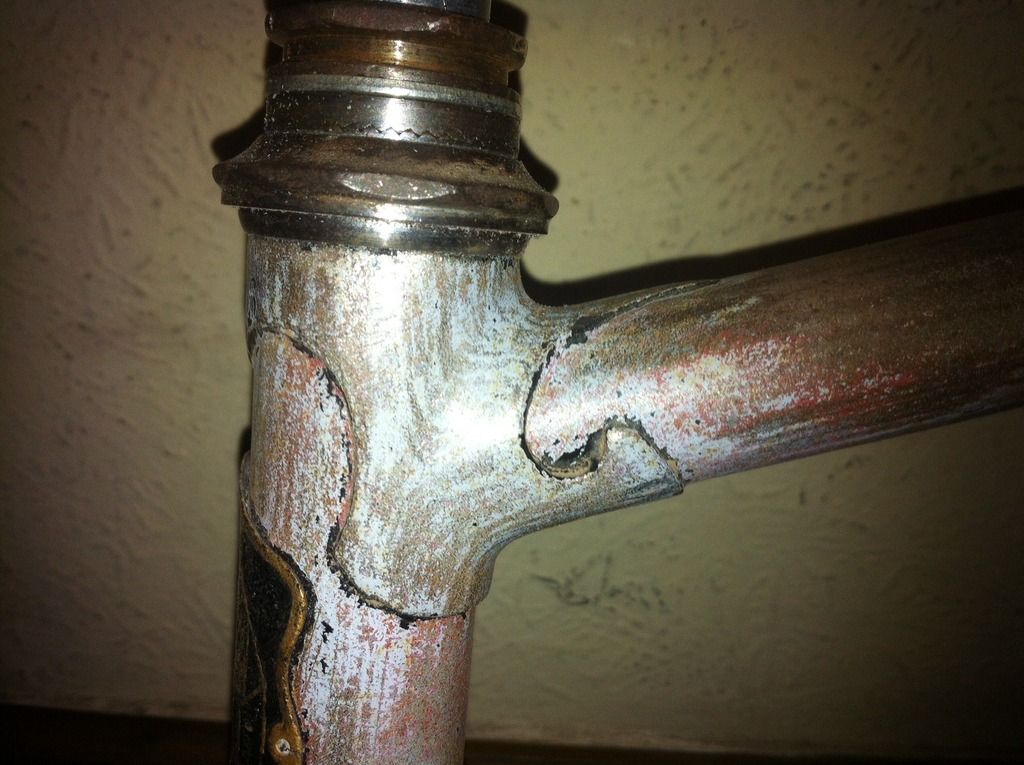

The first job was the frame it was bad! I started off with the idea I could rough the existing paint up and spray primer onto that. So I trialed it on the forks needless to say it didnt work and the high build just flaked straight off after drying.

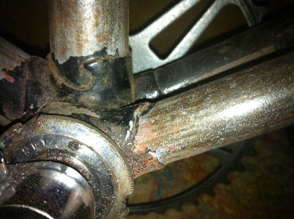

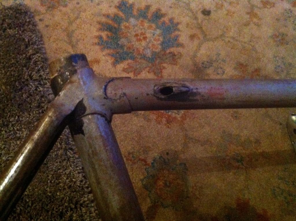

I had no option I had go back down to metal so after a lot of sanding and scraping of what appeared to be black hammerite paint I finally got it to a bare frame which is when I found the frame had the dull orange hue of rust :(.
From stripping the frame down I had decided it turned up something I hadn't even put thought into and that was the 4 holes in the frame. A 1960's frame with internal cabling! I was a bit perplexed but Doniselli were known for one off bikes and there was no sign of them been put in a later date.

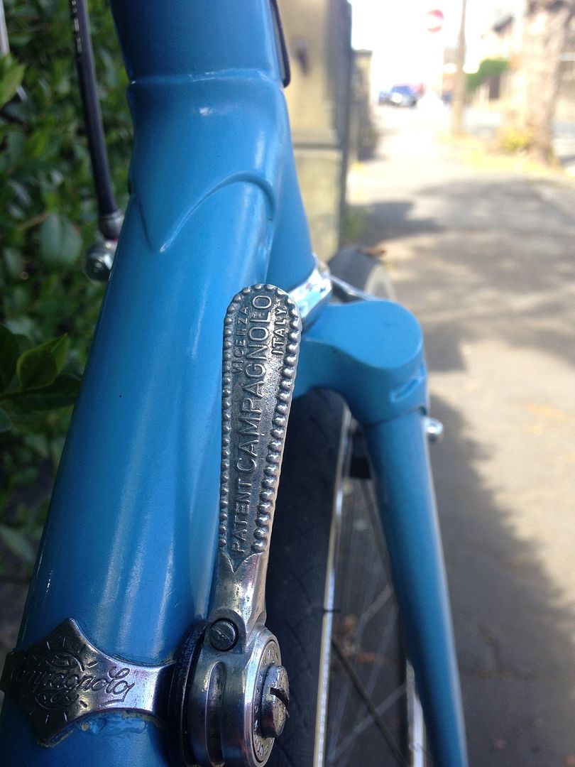

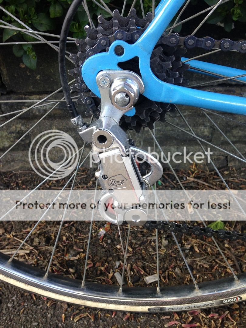

So upon this I decided along with the new paint job I had to setup the internal routing as it would of been. That meant I would need a one by front chain wheel and on the first day of looking I found a single gnutti chainwheel for £15 so I snapped it up straight away without hesitation and the following week I went to a cycle jumble in sheffield and picked up a single campag clamp on shifter and a campag victory rear derailleur as it was very shiny and the simplex one I had looked a bit rubbish. With a fair few new bits for the bike and the frame having a coat of jenolite I got cracking with painting the bike. Id love to say I had pictures but unfortunately I've lost them.

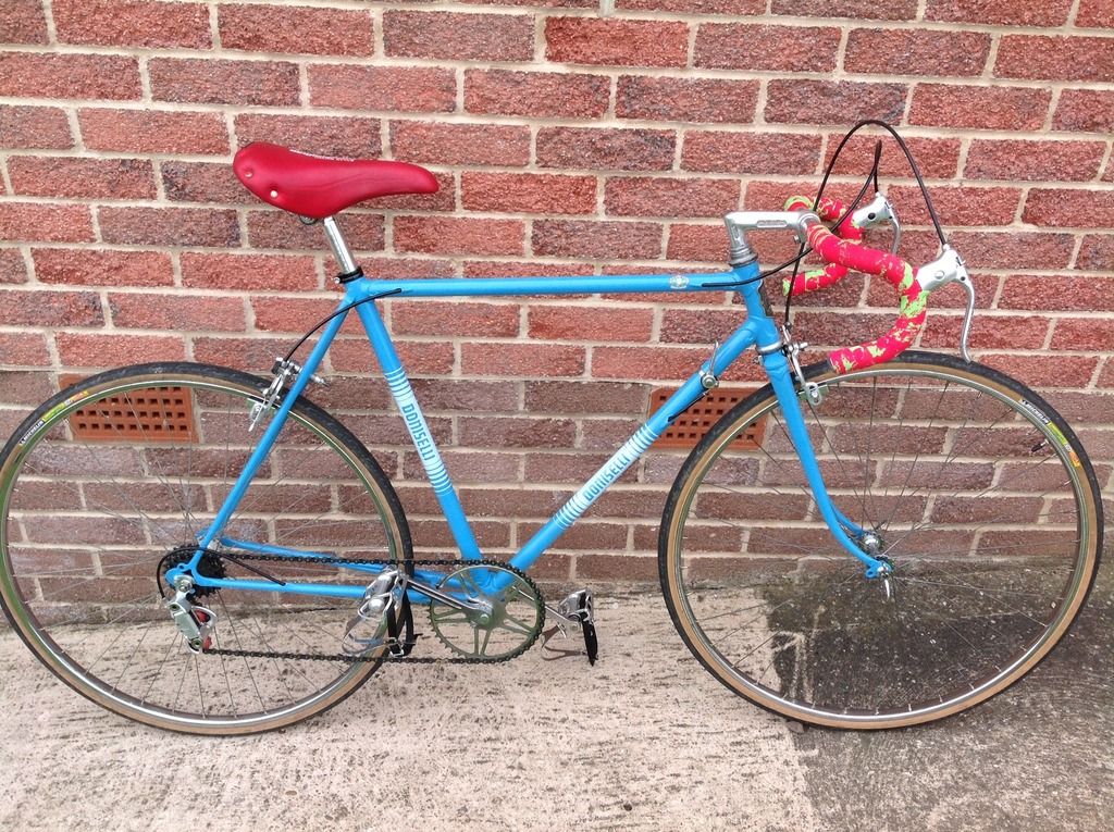

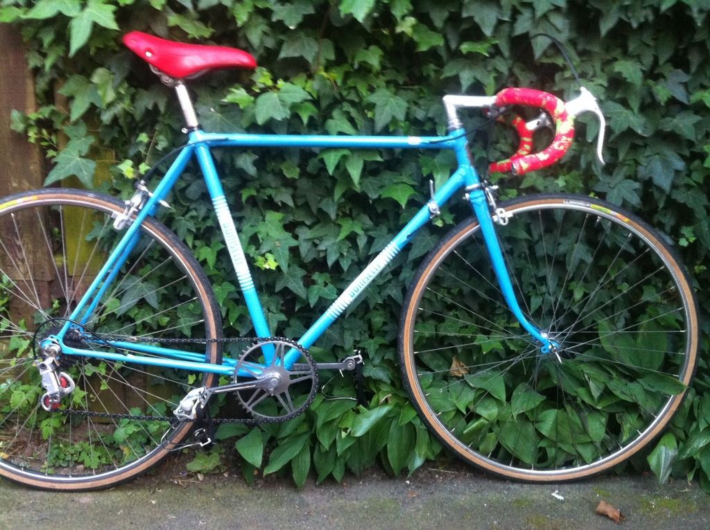

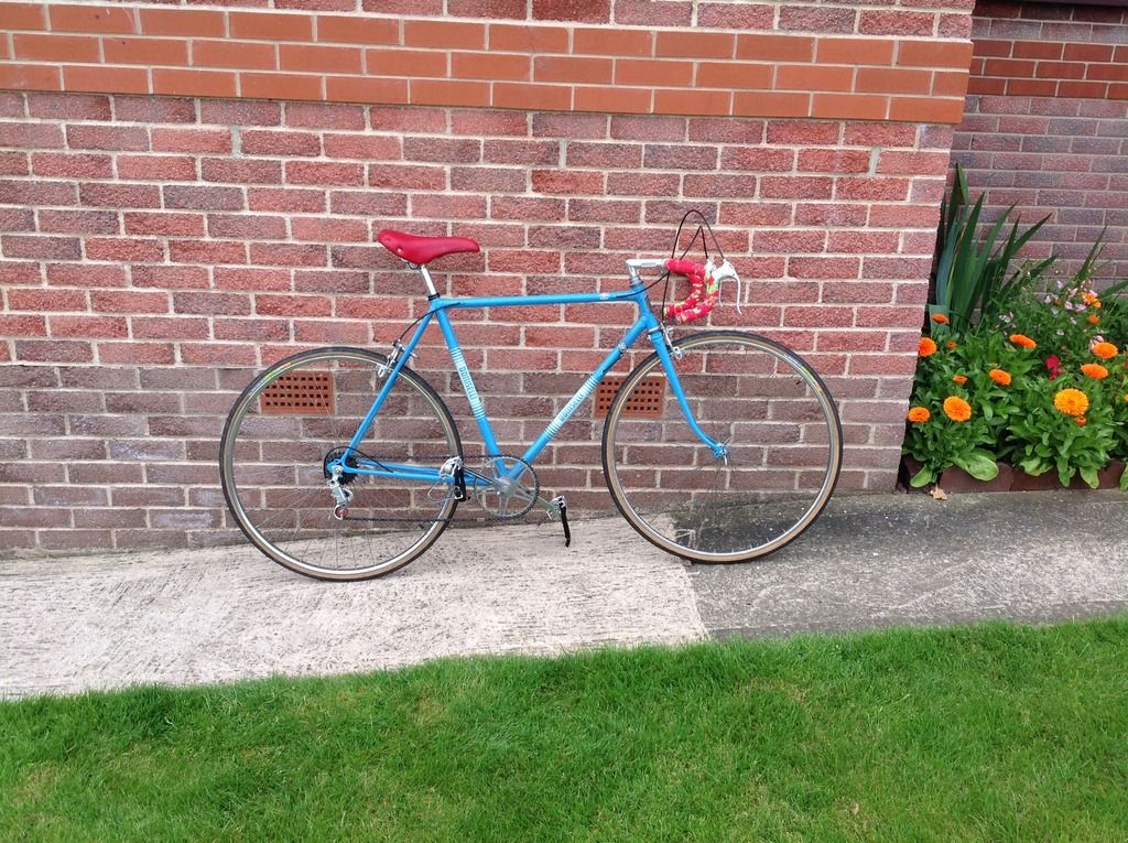

So just before L'eroica last year I got it finished and this is what it looked like!
I hope you like it :D a bit has changed since and there are few bits more I have got... A set of campag wheels with a flip flop hub and campag victory chainwheel which I am going to adapt to a one by.
Hopefully its good weather tomorrow so I can get some more pictures as it is now.
Would anyone care to see the rest of the bikes me and my parents own? A Raleigh record sprint, Carlton Criterium, Rotrax, Carlton Continental or the current project for my girlfriend a Meral mixte? Let me know :D
maybe I'd go with white saddle & white bar tape but its a good solid finish considering what it started off like.
