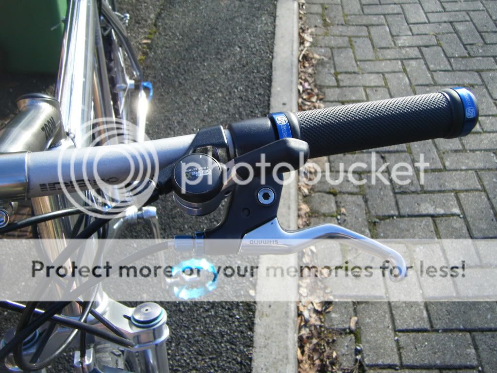

When I got home my grips were waiting
Fantastic!
Here they are:
Another bargain and perfect colour scheme and appearance, nice bungs too
This bit helped sway the decision, the model name 'Tight Bastards' how apt is that!
I went for a quick blast around the block and it works well
