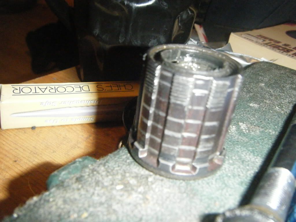

I want to run 11 tooth top gear on the rear and a 50t up front so the old freehub body had to be switched, you can't get an 11t cassette to mount securely
Original body was so old it had threads on it! (for uniglide compatability)
The real problem is the splines go all the way to the end, you need the spines to stop about 1mm from the end of the body to accomodate an 11t cog - Had one on another wheel
Here's the bad body:
Freehub body removal is simply a case of removing the axle and sliding a 10mm allen key into the vacant hole, the freehub is held in by a hollow bolt which you can simply unscrew
It has normal threads (couter clockwise, to unscrew)
Removal:

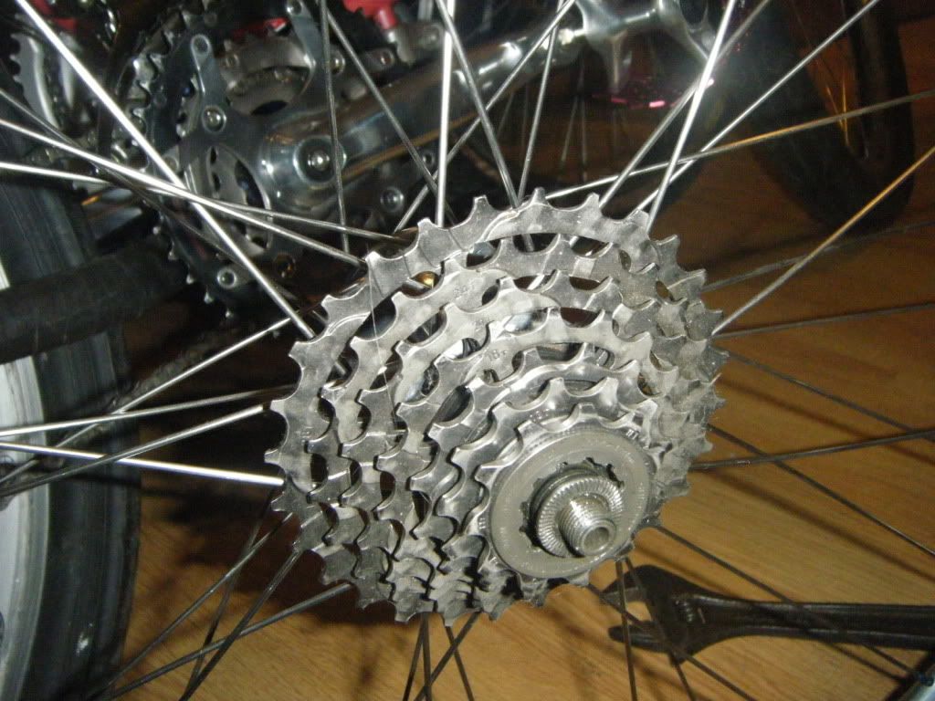

New cassette fitted:
