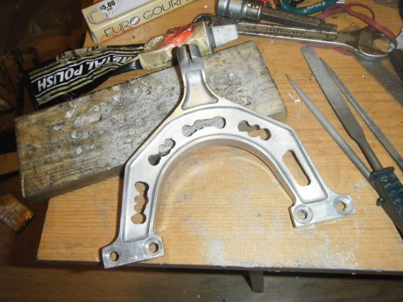

And while the Nitromors was doing it's thing I decided on I'd tidy up the outsides of the forks
So I began by stripping them again, but as I was cleaning the outsides I'd do a total strip
All went smoothly until I attempted to undo the last fork brace bolt
This stuff is 10.9 high tensile steel but the head just rounded right out
- They are done up incredibly tight
Bugger! bit of a pain as it is countersunk, so I got out my old trusty old drill
And drilled
Beat the bugger as you can see. Once the head was split this relieved the compression and I was able to wedge a screw drive it there and get it out
Now I had a drill in my hand and a cunning plan formulated...
I figured I'd put some aero slotting into that fork brace
So I roughed out some holes with the drill, then tidied these up with a selection of files
Long story short here's the finished result:
To be honest I'm really chuffed with the results!
