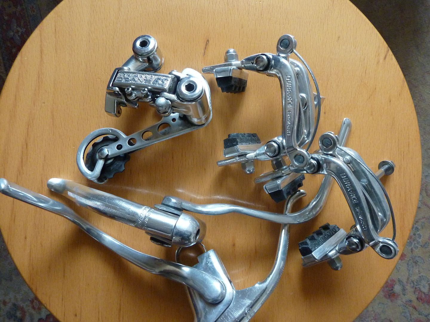

Hey Flandria- don't know if you remember my thread about Dura-Ace brake lever variants? Your Gazelle CM seemed to be wearing a pair of levers like mine- the old 'bulbous' shaped body with slotted blade with non-diagonal logo. IIRC you said those levers were date-coded BL (Dec. '77)
These levers on this thread are I guess DA 7200- the new waisted-shape body with diagonal logo on the slotted blade, and you are saying that these are also date-coded BL?
I double checked it for you and yes, both pairs have a BL code stamped in the body :). Strange situation! Velobase tells me the DA 7200 were made from 1978, but I guess this pair proves them wrong! Or they were not so strict on the date codes back in Japan :). But also, the difference between BL and C is only one month, so no big problem :)
By the way, I'm also thinking about stem and seatpost. Would like to keep it Japanese, so SR?
Thanks. If you have a pair in each style with the BL code I guess that is evidence for Dec. '77 being the changeover month between these styles of lever- I'm calling them 7100 and 7200, I don't know if that's accurate terminology? I can't imagine they had two machines stamping out both styles simultaneously, but you never know... Maybe they changed over at the winter solstice? Maybe you have the last pair of 7100 off the production line and the first pair of 7200... who knows?
Looks like the bar-clamps are different too, with a bolt holding the lever to the clamp instead of a nut?

4. Derailleurs, brakes and headset
First: gears! Rear derailleur will be a 7200. It came on the Olmo donor and I like it more than the first generation 'Crane' version. After a lot of cleaning (least favorite part to clean, for me :) ):
Front derailleur than! For this component, I like the looks of the first generation rather than the second generation. So, first generation it is! Found this one in the parts box. Dismanteled, cleaned, and regreased in three simple pictures:
The headset also came from the Olmo. No pitting on the inside of the cups so some elbow grease, autosol and steel wool gave the following result. Stem is not the one that's going on this frame, but I wanted to see how the headset/frame looked in combination with a polished stem.
For the brake calipers, I went for first generation ones. Frames isn't built for recessed nut brakes so obvious choice. I had a pair of these calipers on a Gazelle CM (in sig!) and took those. The second generation ones that came on the Olmo are now on the Gazelle.
