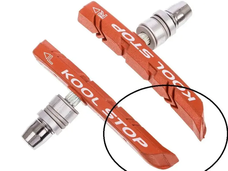

In the pass I have similar problem. The first touch of the pad and the angle is critical. Cool Stop pads have a saphe to install them more easy. Some times requires some error and try experiments. Good luck 👍
I have remember that I have cool stop pads in my XT with that lip and they work amazing, very powerfull. (All Shimano XT 739).
The instalation was easy, the lip gives you the angle. But some times there is a Gremlin and you have to fight with him 🙄
Does Kool Stop also make brake pad inserts?
I don't know if they make now, that bicycle built has some years. But they use to make several types of brake pads inserts: dual compound, for cerámic, agresive compound etc
Mine are the dual compound: normal (black) and agresive (Brown)
