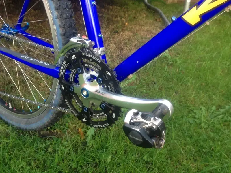

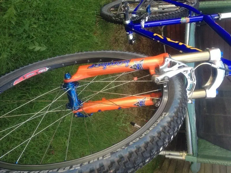

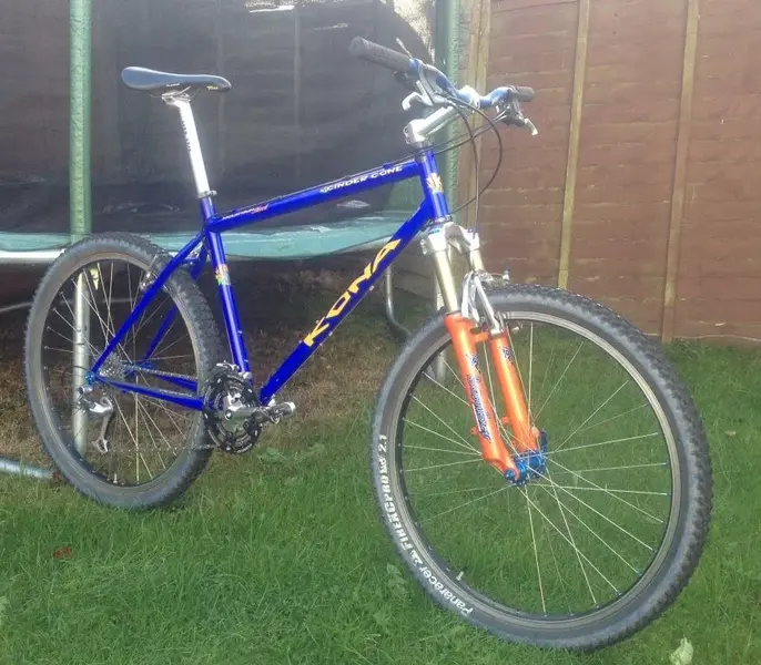

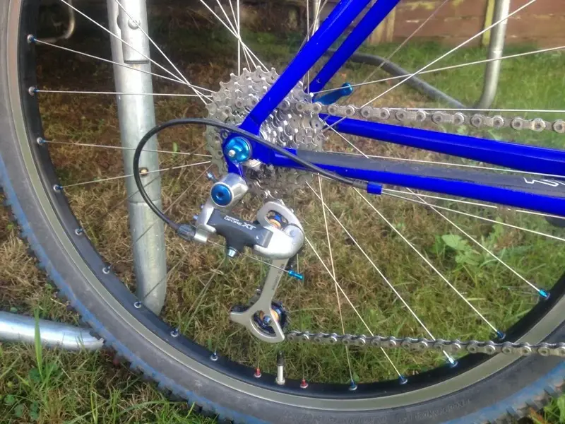

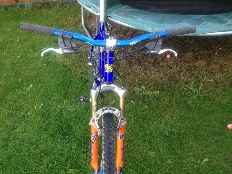

well it's together, barring any tweaks that may be required.
Took it for a short test ride round town this morning, down a few steps and off a couple of drop-offs
other than the front mech already mentioned above, the forks appear to be a bit on the soft side, so will have to check them out, and a little front brake squeal to be sorted, all appears ok. :D
Spec is as Follows:
Frame: 97 19" Kona Cinder Cone
Fork: 98 Marzocchi Bomber Z1
Headset: Cane Creek S2 with ti bolt
Stem: Unknown alloy aheadstem with ti bolts
Handlebar: Club Roost Comp II riser bar
Grips: Unknown
Brakes: Shimano XT BR-M739 Front and Rear with ti bolts
Brake Pads: Clarkes
Brake Cables: Clarkes
Brake Levers: Shimano XT STI M739 with ti bolts
Shifters: Shimano XT STI M739 with ti bolts
Front Derailleur: Shimano FD-M739 26.8mm band Top Pull with ti bolts
Rear Derailleur: Shimano RD-M739 with ti bolts, ti adjustment screws, alloy breakaway bolt and alloy jockey wheels
Derailleur Cables: Clarkes
Cassette: NOS Shimano XT 11-28
Chain: Shimano IG70
Cranks: Shimano XT M737
Crank Bolts: No brand self extracting
Chainrings: Race Face Team 22/32/44T
Chainring bolts: Token/Middleburn
Bottom Bracket: Shimano UN55 68 x 113mm
Pedals: NOS Shimano PD-M505 Spuds
Hub Skewers: Hope
Rims: Salsa Delgardo
Hubs: Hope Mono 32H
Nipples: DT swiss Alu nips
Spokes: DT swiss revolution spokes
Tyres: Panaracer Fire XC Pro (folding)
Tubes: Continental 26x2.5
Saddle: Selle Italia Flite Titanium 1990 (reproduction)
Seatpost: NOS Handsomedog Lite Stik Silver 27.0 x 400mm
Seatpost Binder: Kona
Other bolts: Blue Ti
Weight: 27.33 lb

That is sweet. Love the bombers and blue ano too
I did wonder if it would be too much blue, what with the blue frame and all, but it actually works ok.

Cheers, I've now sorted the front mech issues, it was the BB, fitted a 107mm as recommended by Fluffychicken and others and it seems to be good.

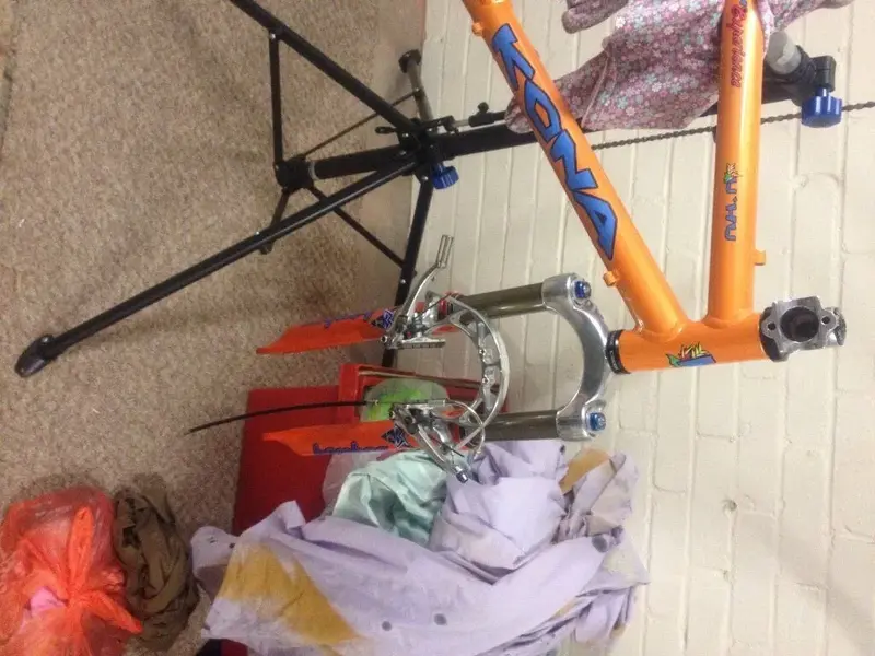

I went for it....
The other weekend I swapped the Orange frame & forks for the Kona U'Hu frame with Cane Creek Air shock.
So I'm now stripping the Cinder Cone frame, and cleaning all the bits ready to build up the U'Hu.
I've also acquired a few more bits towards the other builds also:
Some nice Aerozine chainrings for the '96
and
Some lovely purple bits for the '94. I seem to recall purple being all the rage around then :lol:
I did take the set of NOS Pulstar hubs down to SJS to get a set of wheels built, but the cost of the straight pull spokes blew it out the water! Will have to consider alternative hubs for the '94 now.... I do have a decent set of M737's but I'm also eyeing up some M900's that I've seen...
Some pics will follow when I start to rebuild something... :facepalm:

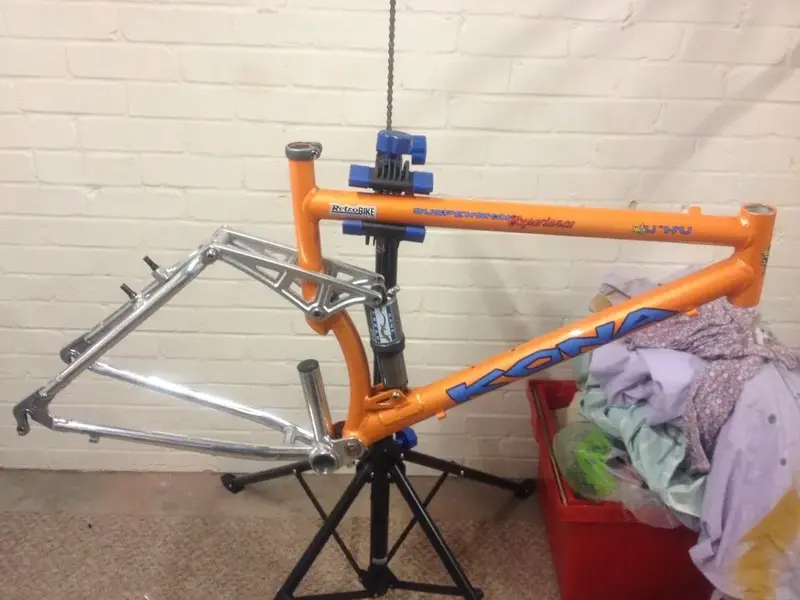

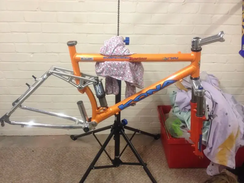

Pics as promised
Firstly thanks Gruff for the lovely frame....
And I've now added the UN55 BB, the Cane Creek S2 Aheadset that came with the Cinder cone frame, the Z1 Bombers and the front M739 V's and the no name ubiquitous late 90's alloy stem:
Being the Weight weenie geek I am I thought I'd weigh the bare frames just out of interest....
(All frame weights include the seat clamp and dog collar if fitted and the BB cable guide)
94 19" Kilauea = 2058g = 4.53lb
96 18" Kilauea = 1965g = 4.33lb
97 19" Cinder cone = 2137g = 4.71lb
97 19" U'Hu = 2931g = 6.46lb (inc shock)
Hmm the U'hu aint gonna be a lightweight is it?
