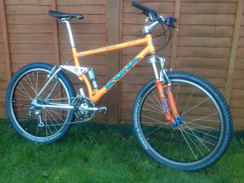

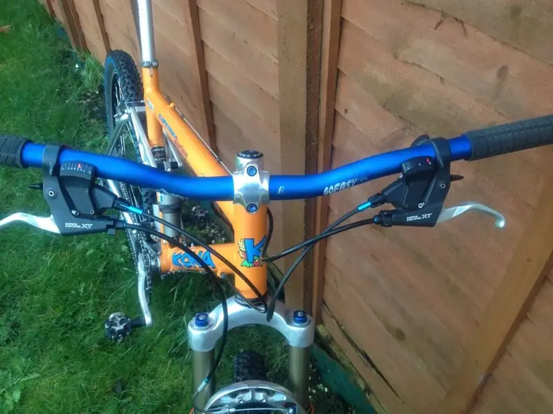

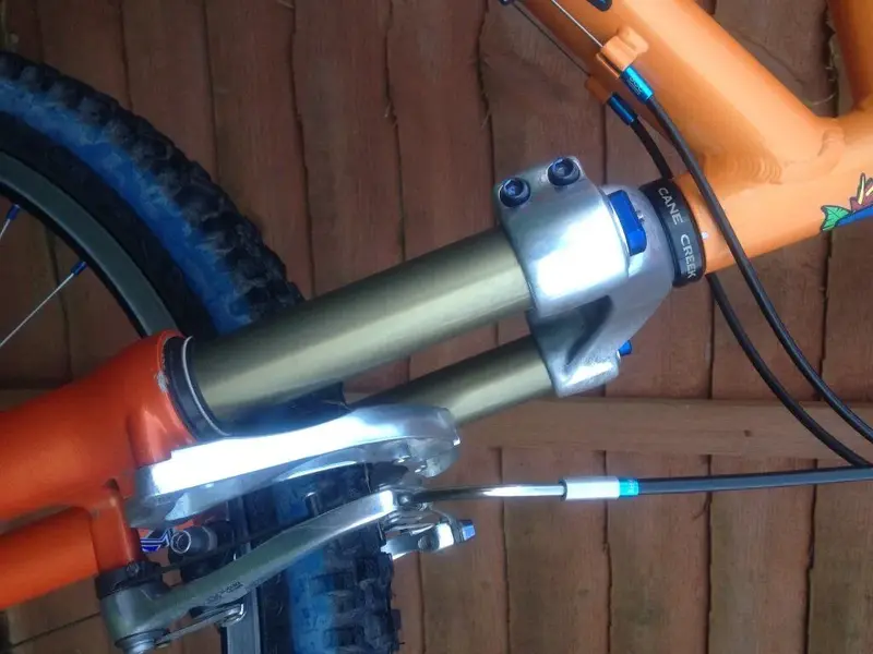

Finished swapping the bits off the Cinder Cone onto the U'Hu on Saturday and cabled it all up.
Here are some pics from this morning just before a quick test ride round town to check it all functioned ok and set up the air pressure in the shock.
I started at 170psi (I'm about 73kg) but this was too stiff, so lowered it to 130psi, this resulted in too much pedal bob, so settled on 150psi. I've also concluded that I need to get some stiffer springs for the Z1 as they go through their travel very easily even with full pre-load applied!

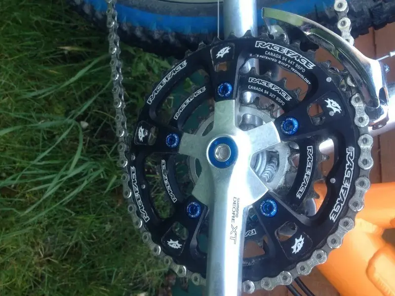

Anyway here are some pics of some of the details:

Cranks: Shimano XT M737
Crank Bolts: No brand self extracting
Chainrings: Race Face Team 22/32/44T
Chainring bolts: Token/Middleburn

That looks great Matt but very weird watching a build on my old bike :xmas-cool:

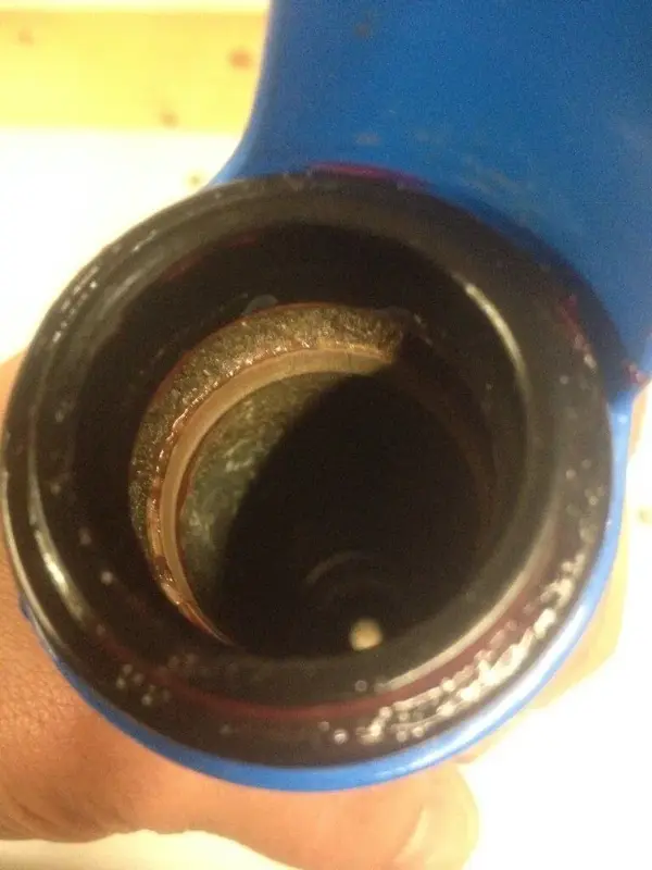

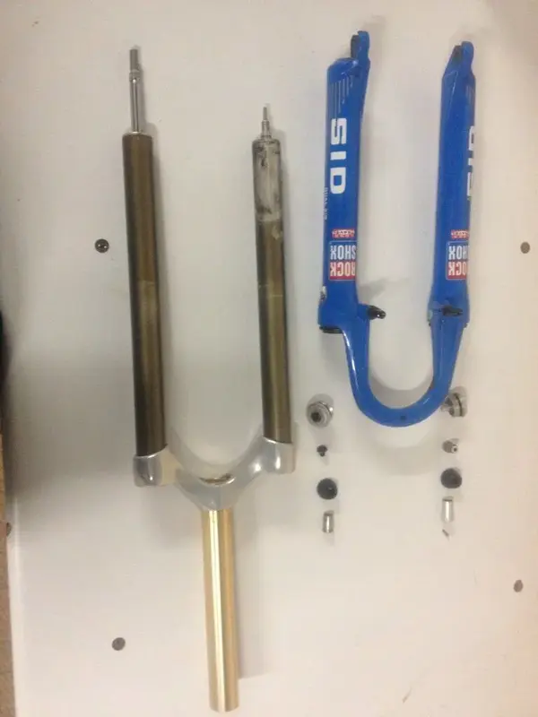

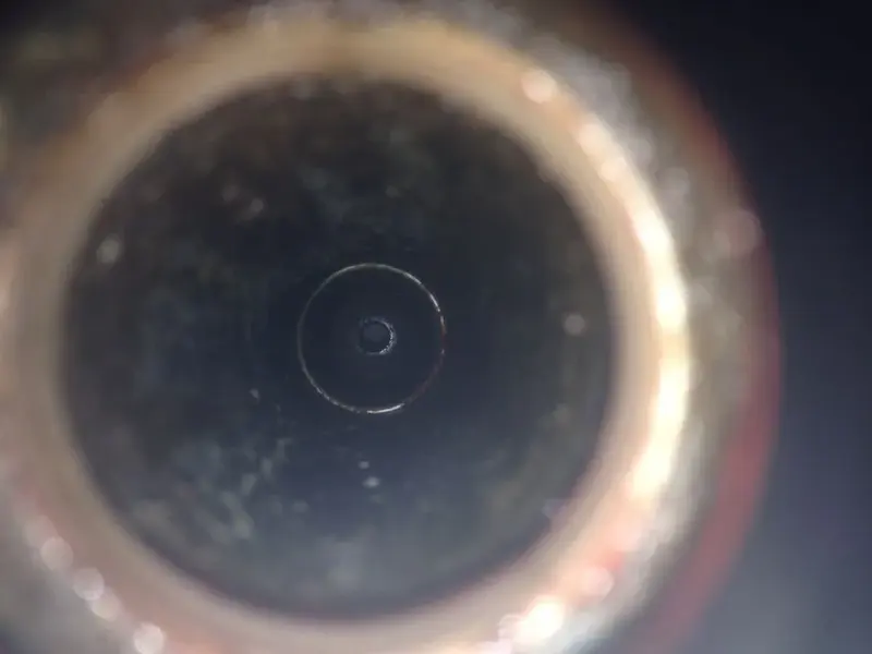

Firstly the forks.... I want this to be a xc lightweight so I purchased a set of 99 SIDs off here a little while ago, they looked very good, unfortunately they hid a dark secret.....
I must say the seller was very good to his word and gave me a full refund as they are basically knackered! I also got to keep the forks.

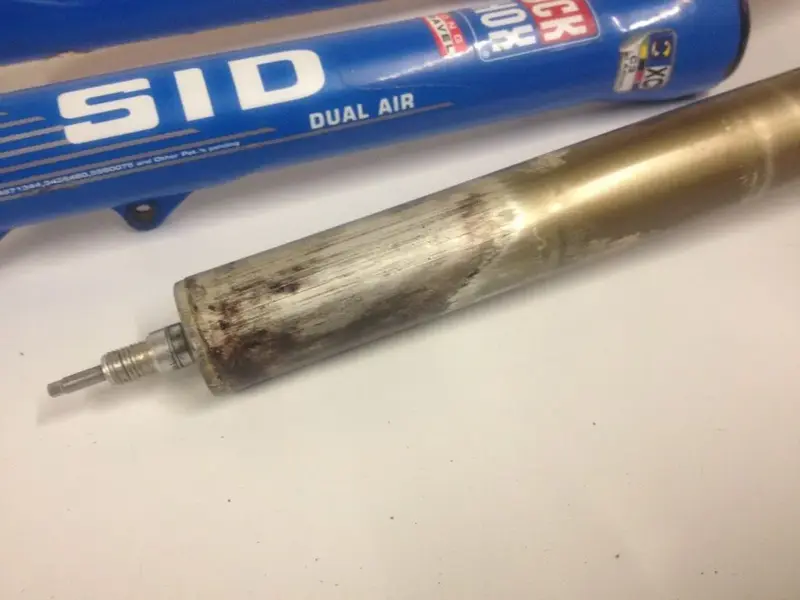

It would appear that some sand has got inside and ground the stanchion at the lower bushing.
Now I thought I'd have a go at rescuing these as the wear seems limited to the bushing areas not the seals.

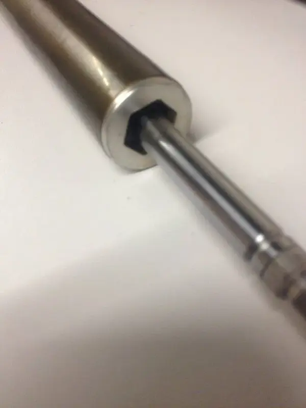

First stage is to fully disassemble them.... Has anyone got any idea where I can get the tool to undo the negative spring and cartridge? it needs to slide over the shafts & fit in the hex in the photo below

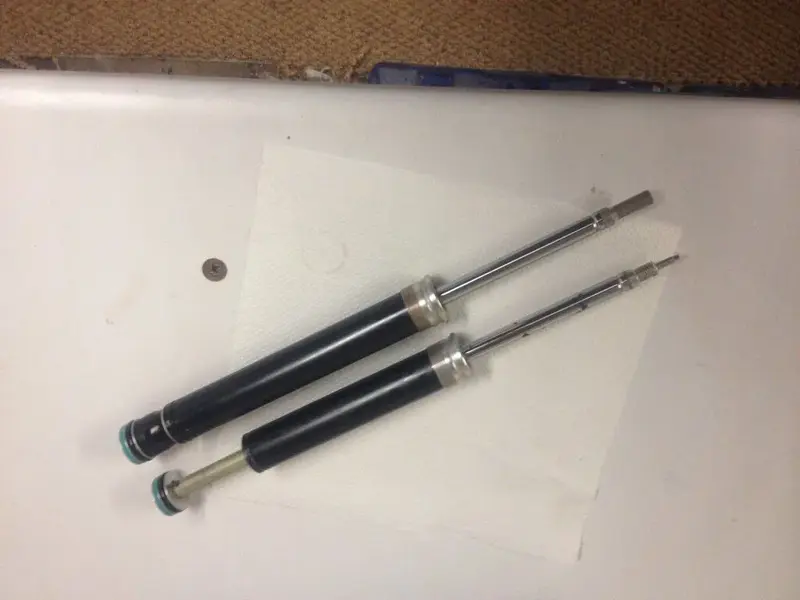

Well I improvised, I needed a 15mm tool so I found a nut of a similar size and drilled the middle out to 11mm, just enough to slide over the piston rods.
Got the negative spring assembly and C3 cartridge out, but now it seems the cartridge is dead... I can hear the oil cavitation when I move it through its travel, I think it's lost oil, which would seem reasonable given the piston is pitted and rusty. Great Now I need to find another cartridge.... this set of forks might well be dead after all....

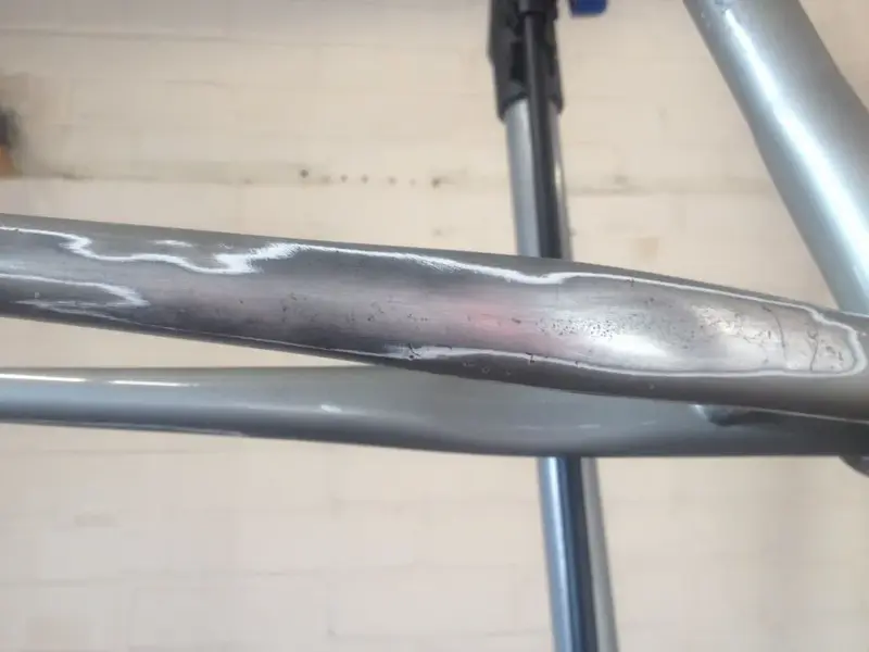

Now I'm debating what to do with the frame, it has most of its original paint, but a lot of scrapes with surface rust. Do I leave it? Do I just touch it up for now? or do I go the whole hog and get it powder coated?.... (I'll post a pic tomorrow)

firstly a couple of pics of the C3 cartridge...anyone have any idea where I could find a replacement?
Now the 94 kilauea frame.... made a decision to investigate the rusty bits on the driveside chainstay.... err gonna be a full repaint then :facepalm:
Hmm what colour to go.... Silver does go with pretty much anything and would keep it looking fairly original.... hmmmmm
