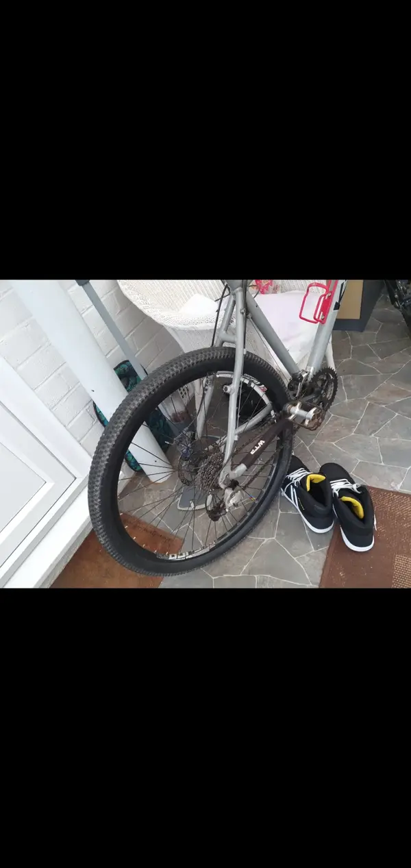

I'm going around in circles deciding on the next build. Frame: 26er singlespeed hardtail, seems to be long travel judging by the 71 degree ish headtube angle which I guess equates to 120/140 suspension corrected.
I prefer to keep it 26 for 'purity' but 27.5 opens options particularly regarding rim and tyre choice.
So option one is wait around for the right 26er parts - rims being a bit difficult I think. 120 suspension less so but straight and long steerers aren't ten a penny (130mm headtube) and I'm fussy. Or, could I use a 29er carbon fork, say 470 atoc, with a 26" wheel.

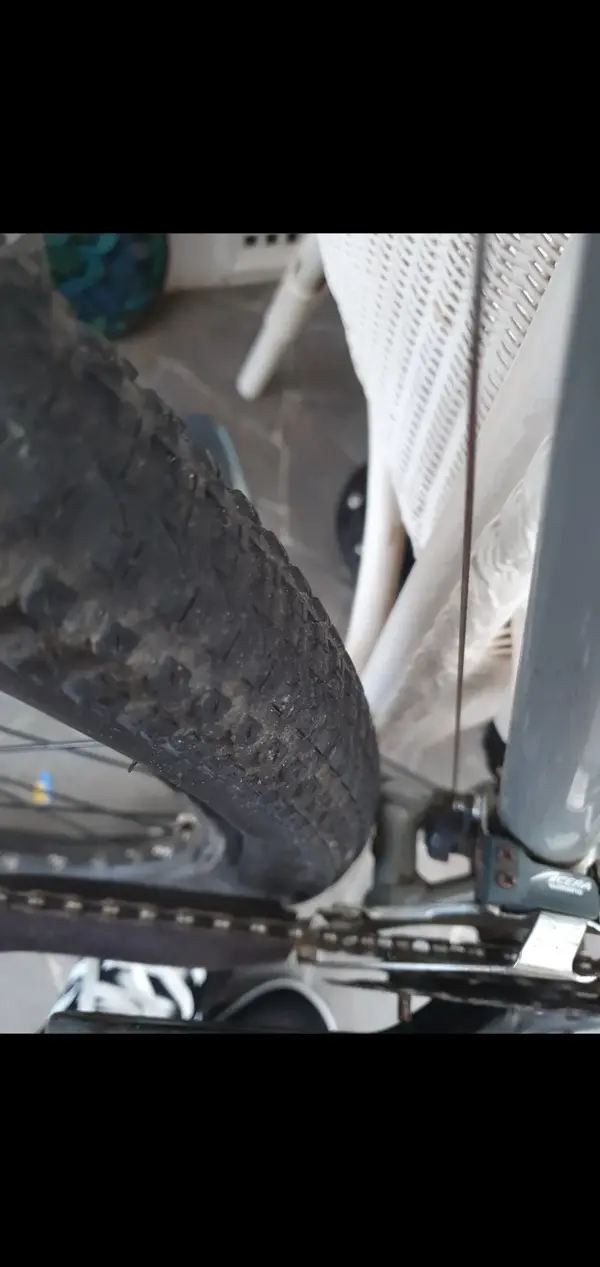

Alternatively, convert to 27.5. Stay clearance looks okay but 292mm 27.5 wheel radius plus tyre depth looks mighty close to the stay bridges.
I'd make it work as intended if I were you. I like 27.5 and for day to day riding would choose it over 26 but I reckon you'll run in to problems. Last thing an older bike wants is a higher bottom bracket too! Oh, and since the mainstream seems to have ditched 27.5 decent tyres are getting pricy anyway.

All kinds of stuff you can do with the front wheel, but only so much you can do with the rear. You can cram a bigger rim in there, but not a bigger wheel in terms of diameter. Given the limits on diameter, I'd just as soon put a fat (ish) 26" tire back there.
I converted a frame like that into a 69er. Nice conversation starter. To just ride the thing, I woulda been better of with 26 F&R and a decent suspension fork. That rear wheel is your limiting factor. Is what it is.
There's a million 26" rims out there. If you're running rim brakes, TBH there's nothing wrong with the Rhyno Lite. It's not terribly Lite but not terribly heavy either, and it seems sturdy enough. Possibly not the worst choice in the world considering what that bike was likely designed for.
Plenty of super nice 26" tires out there too. On my "primary" off-road 26er, I'm running an Ikon w/ Rhyno Lite on the rear, DHF 2.3 on a Rhyno Lite XL rim on the front. It's not a bad setup. Fun bike actually. Not gonna win any races, but who's racing those things eh. Price was sure right.
I have a kona an the rear end acce9ts a 27.5 with no issues.
Photos for reference
