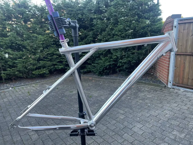

Started the long process of trying to remove all scrapes with wet/dry. Had to go slightly rougher than I’d hoped but it should clean up mostly. It’ll be a few sessions working through the grades before it can be polished.
It's a war of attrition (abrasion) but you'll get out what you put in. Look forward to seeing the results.
Had a bit of time on it today. It’s not perfect as some scratches are a little too deep to remove but it’s 90% I’d say. Once decals are fitted and components on it would hide most imperfections.
Currently on P800 grade so needs to go higher before polishing can commence
So a update
98 frame is prepped for anodising but unfortunately Acorn have let me down by never replying to my emails or answering the phone which is disappointing.

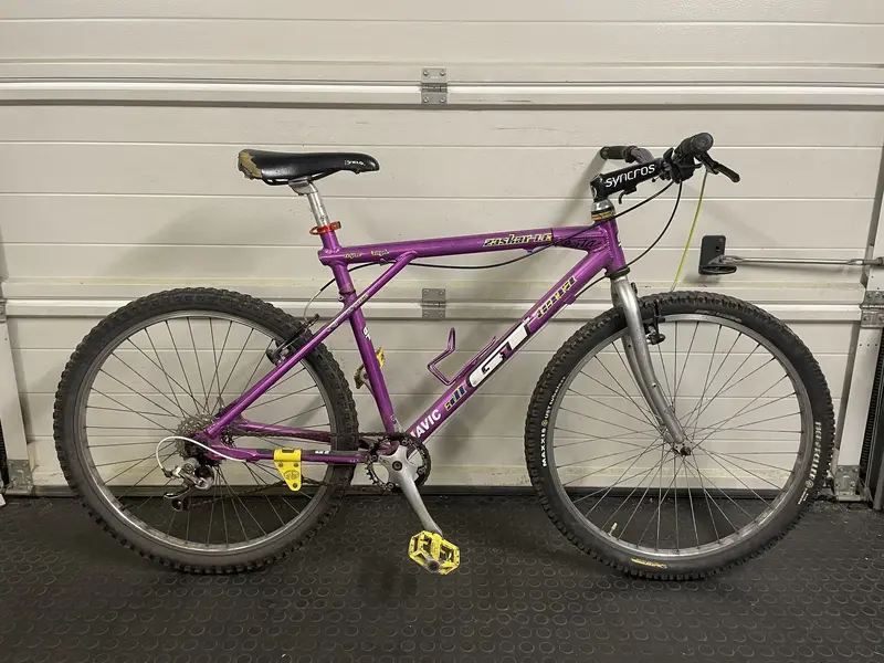

However I did a 6 hour trip yesterday to fetch a purple Zaskar which isn’t mint (far from) but it’s a step towards the collection being full of the colours. B8499B43-FCE0-4A81-B9F4-10EFBB5126D7.jpeg C5859F98-938C-4C2B-A66F-AEFE2C39B880.jpeg EEB19905-58A0-451E-AF92-A4F7BA01CA0A.jpeg DEE4025F-F952-41CB-B556-13A50BB7D43F.jpeg
