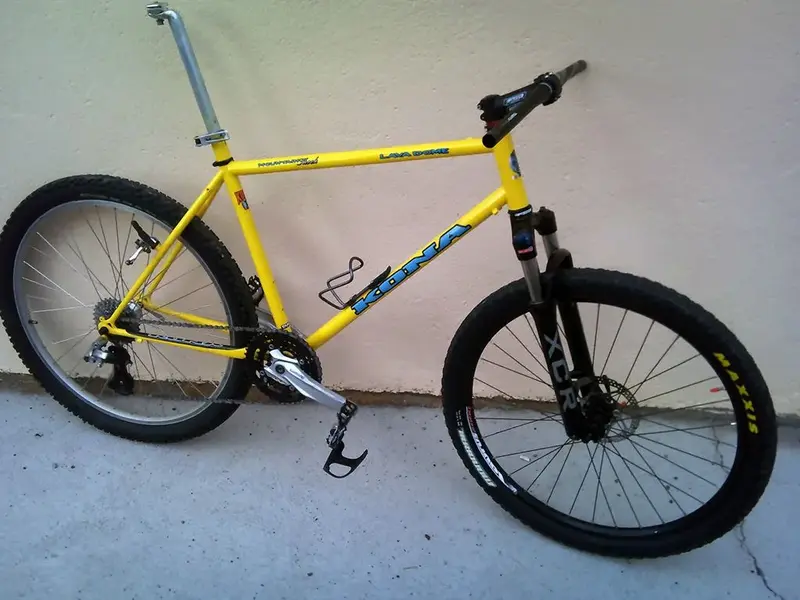

That´s my KONA Lava Dome
davigar
Enjoy!

Thank you!
It was too hard to restore and repaint the frame and make my own decals set, but it also is funny to collect and place each component on.
It´s very reconfortable to see how an idea born in my mind and finaly takes place.
Frame: 1993 Kona Lava Dome Tange CR-Mo double butted. 20' size.
Fork: 1 1/8 Rock Shox Reba RL dual air 2012 80 mm
Headset: FSA Aluminium sealed bearigns
Stem: Scott
Handlebar: Scott pilot 15
Grips: Pro neopren
Barends: Unknow
Brakes: Front: Avid BB5 with 160 mm Deore SLX rotor. Rear: Deore LX BR-M570 V-brake.
Brake Pads:
Brake Cables:
Cantilever cable hangers: Original KONA collar dog.
Brake Levers: Deore Lx BL-M57
Shifters: Shimano SLX SL-M660 9v
Front Derailleur: Shimano Deore LX FD-M571
Rear Derailleur: Shimano XTR RD-M952 9v
Derailleur Cables: Inox
Cassette: Shimano Deore HG63 11-32t 9v
Chain: Shimano SLX 9v
Cranks: Shimano XTR FC-M952 24-34-46
Crank Bolts: Shimano XTR
Chainrings: XTR M952
Chainring bolts: 4 aluminium Bolts
Bottom Bracket: Shimano 105 Octalink v1 118.5mm wide
Pedals: Shimano PD-M520
Hub Skewers: 2009 Mavic Crossride
Rims: 2009 Mavic Crossride Vbrake/Disc
Hubs: 2009 Mavic Crossride Disc
Nipples: Mavic
Spokes: Mavic
Tyres: Maxxis Crossmark 26x2,10 kevlar
Tubes: No tubes
Saddle: Selle Italia SLS Flow
Seatpost: Tioga Tbone 26.8 mm
Seatpost Binder: Kalloy UNO
Weight: 12.7 kgs at all
