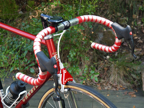

With modern Bike Ribbon type tape I start at the bottom and end in the top middle with some fancy multi-colour taping. With Benotto I start at the top middle and finish with tucking in with a plug.
I also used to start with 2 sections, one at top middle and one at bottom and finish by tucking the ends under the rubber brake lever hoods. This can be quite neat.
There is also this method -
http://www.wastedlife.org/bike/harlequin/index.html
Yet to try it myself but hope to one day!
ragnar....."as featured in my Chesini X-Uno thread."
That's a stunning bike. Just put it on my desktop. :P
Pete.
