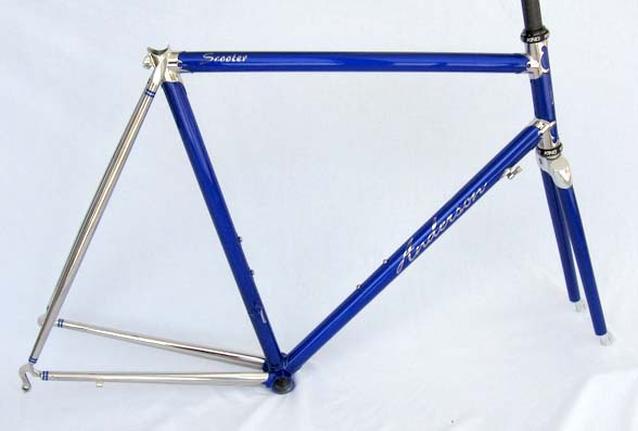

It's boring round tubing to look at, though
Don't have to build boring frames with it though:
