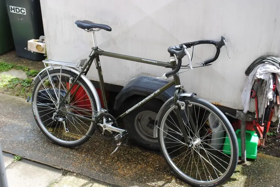

So, I'm bored. Run out of projects and budget so look around the shed and garage to see what is available
And here you go, a Topanga on drops and slicks.
Bitsa build, even the shifters are different! It all works swimmingly though and the ride is pleasant as these frames were used throughout the range and feature full double butted tubing and Tange forks.
Was hoping to use a matching LX front mech but cant find the roller for me adapter.
Am waiting for tape

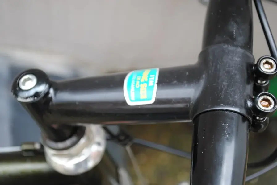

Total costs, ooh, about £17 all in inc that rather nice alloy headset. Cant remember where the stem came from - quill stem with oversized bars eh? Who'd a thunk it.
