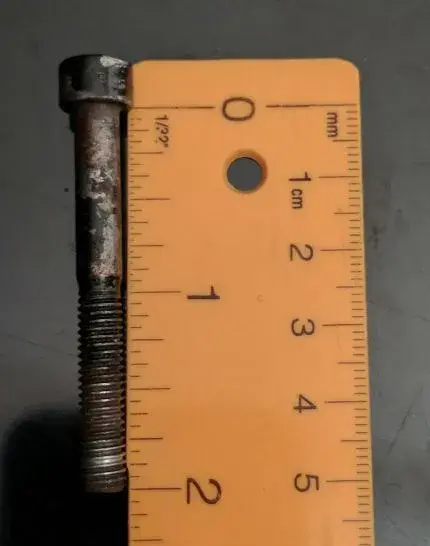

I had a fun time finding the right bolts online for the V2 (or V3 depending on who you ask) syncros seatpost I have. It was difficult to find due to being in Canada, and some of the major bolt distributors not shipping here.
https://www.amazon.ca/dp/B00B3RIVF0/
This bolt seems to be the one though for Canadians in the same predicament as me. Sounds like it's coming from the UK though. The length and thread count seems to be on here to be a good replacement.
Specs:
M6 x 50 Socket Cap Screw- DIN 912, A2/70 Stainless Steel, Not Threaded Full Length, Threaded Approximately 25mm, Thread Diameter- 6mm, Thread Pitch- 1.0mm, Length- 50mm, Head Diameter- 10mm, Head Height- 6mm, Allen Key Size- 5mm, Screw Length Does Not Include Head

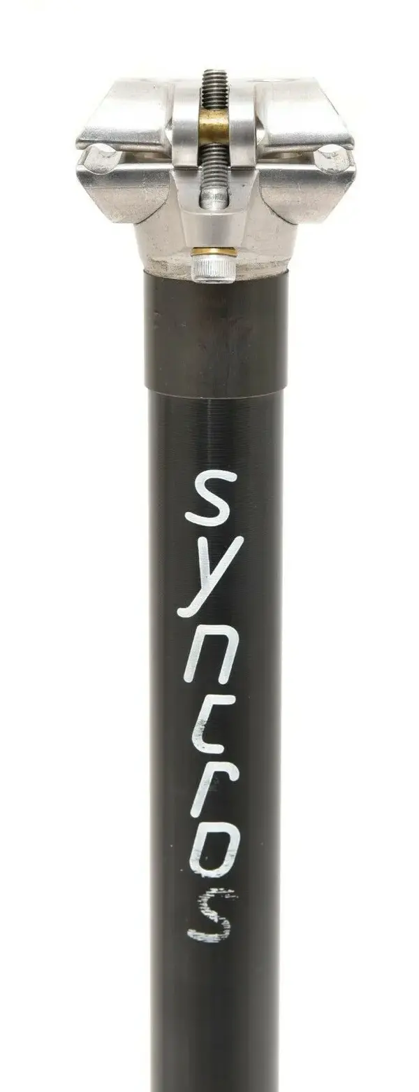

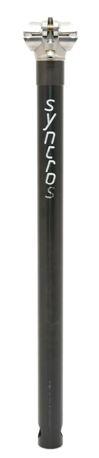

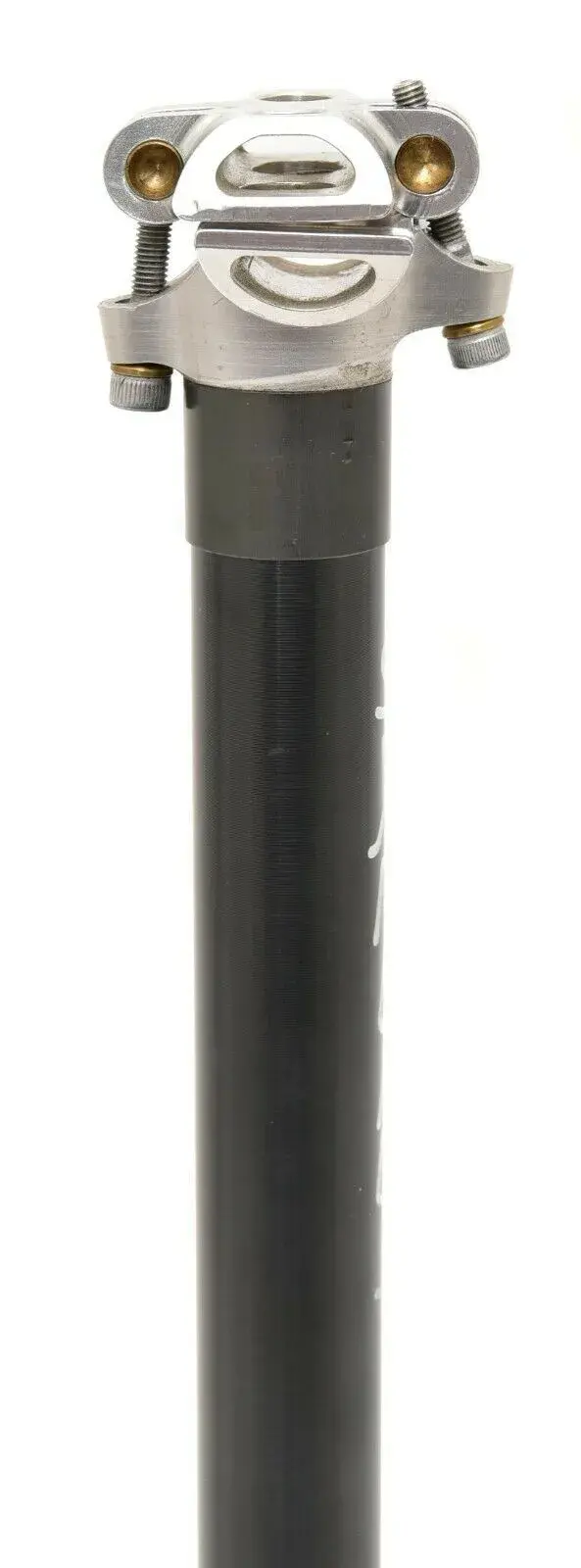

I know this original post is from years ago, but wonderfully interesting nonetheless. Thought I'd had a photo of a recent pickup. Decal is on the backside (below one of the nuts) and has a similar bevel (base where brushed meets anodized) as the second generation, but not the flat plate of the second generation. Maybe a late second generation or early third - however way you want to look at it.
