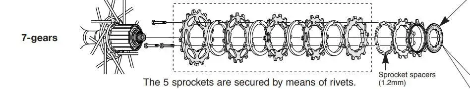

Another thing, the cassette is supposed to have three pins or rivets to secure it (see pic), however it was fitted without these, should I look for some? Or will it be fine without? I've tried fitting it to the new hub and it all seems to sit nice and securely without them.
