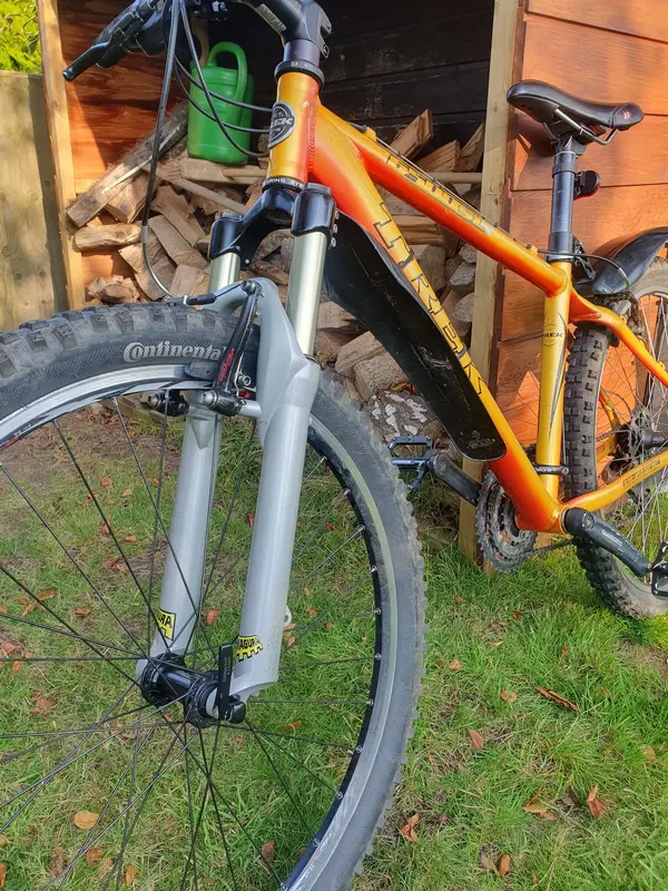

Took the advice and bought some magura forks off ebay for £58 and they are lovely. Bit of a mission for a novice to fit and had a bit of a nightmare but so pleased with end result, bike rides lovely. Pic attached if anyone knows the fork model. Few bits left to sort but so glad i saved this bike. Thanks again.
