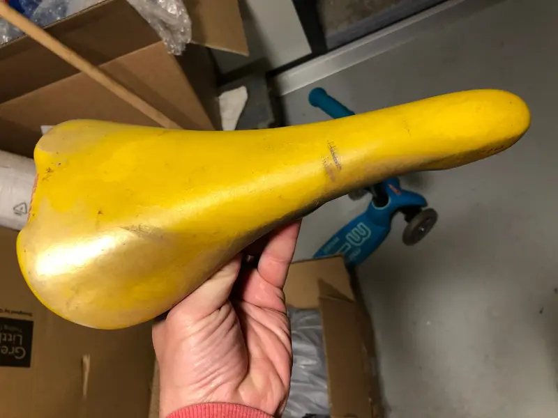

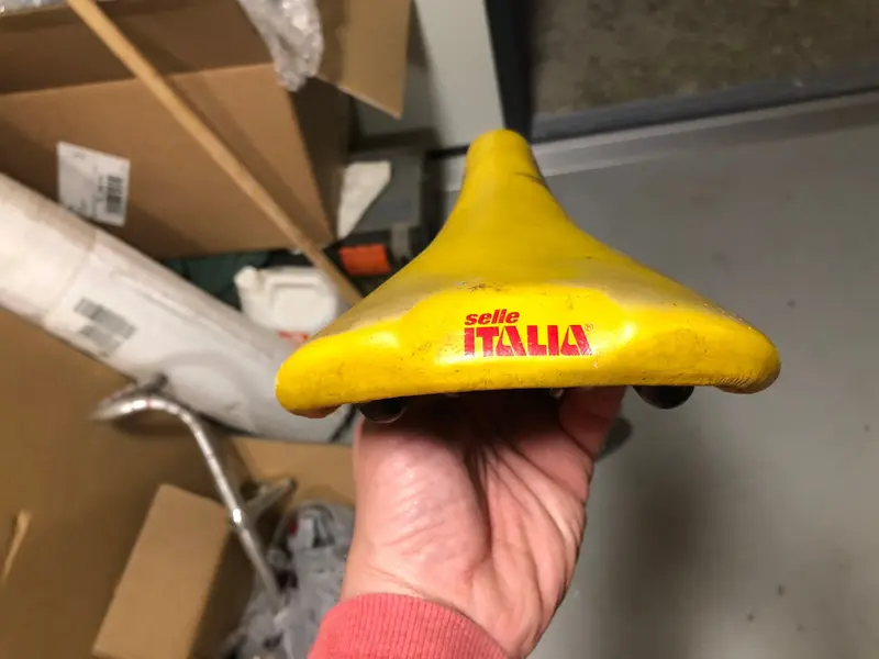

Soooo.... whaddya reckon can be done with this?
Those are the photos taken by the seller (Cheers Mat!). it's clear through to leather in a few places.

I think that’s likely to come up an absolute treat... it’s the ones with the great big chunks chewed out of them that I think are a bit beyond saving.
Isn’t that the same one?
Cracking job if it is...
But if not, yes, I’m sure you can.. it really isn’t rocket science.... I look forward to seeing it progress

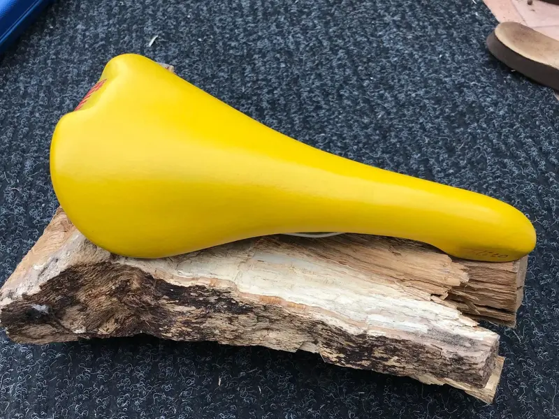

Yup. Good eyes that man!
it needed a LOT of layering to stop it being patchy. I've done a little bit of leather work before, so knew it might not work; light colours & leather are not a happy mix. I ended up using 3/4 of the bottle of pigment, with quite a lot of layer sanding. With 4 coats of sealant.
Watering the pigment down a little helped massively with getting the layers flat, and brushing gave better results than a sponge in the end. The leather prep in the kit is just surgical spirit (probably) and I thought most of the rest of the stuff in the kit was a bit of a token effort... But, the pigment and top coats are really excellent. I ended up going for the satin finish too.
Huge thanks to peachy for spotting this - it's not cheap, but really does work.
FYI, after a few coats I gave the finish a bit of a torture test (without sealant). It's damn tough. unless I used chemicals I couldn't get any of the yellow to rub off on anything. With sealant, I suspect this is going to last a LONG time.

Superb... I did wonder if the coloured versions might need a little more TLC than the black..

Awesome results
Any idea if this would work on a white Flite as mine has areas where the colour is wearing thin
I don't see why it wouldn't, but be prepared to do many layers. Yellow is a notoriously bad colour for showing through, white, not much better...
