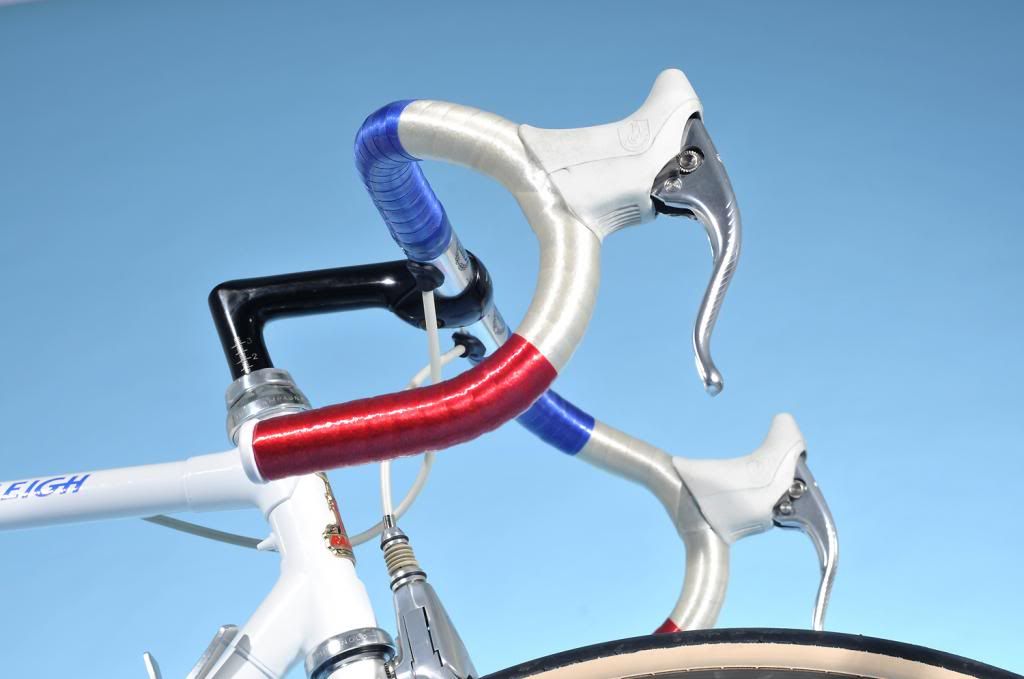

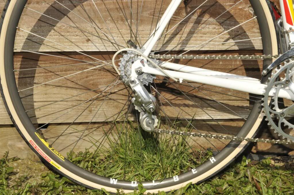

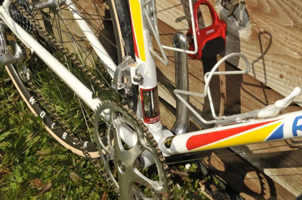

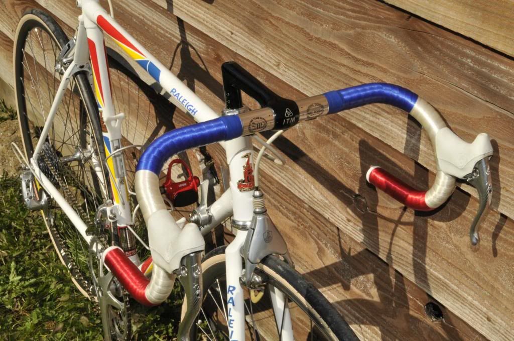

Hiya, well finally it's done! I had a bit of a crisis last night as the chainline looked like it was way out. With the chain on the small ring and small sprocket the large ring would rub the chain. I am still not convinced that something is a little misaligned but it tracks true and I have bodged a solution for the time being. The rear wheel needed redishing so I did this with the wheel in the frame, loosening all the spoke on one side then tightening them on the other to bring it across.
The brakes are an arse to adjust but I got to grips with it and would you believe the Syncro II works perfectly? Me neither, but it does...I thought this would be the biggest pain of the whole build but it turned out to be fine.
Final pics posted for now, not my finest camera work but I hope to let a photographer friend have a go with it in the studio before I get it dirty!

I was right about it being lunchtime, had to make a trip to the LBS as I needed to see what he had to say about the chainline and check the frame alignment. Brian Hoppe in Sherborne is a real gent and is sadly retiring in July, I will miss his quick service and excellent work especially when it comes to wheel repairs.
