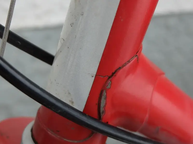

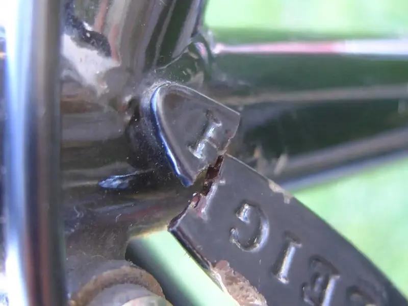

I have snapped 3 such frames in the last decade, all failing at different points on the frame. It was kind of surprising considering these bikes were looked after and not ridden frivolously. The third (a rear dropout failure) I didn't think to take pictures of.

Fatigue.
Those embossed raleigh stay covers are a classic weak point, but around then raleigh frames seem a bit brittle.
I suspect they were getting a little hot on the hearth, and maybe cooling them too quickly
