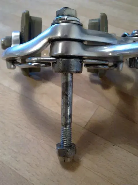

Sorry for slow reply... Here is a picture of the Superbe bolt. 8cm long in total, 4.7cm of which is behind the caliper. Any bolt that will take the spring should do the job.
Nick

Proof of the pudding: here is a front Superbe caliper built up with a rather tarnished Weinmann 8cm centre bolt. Works OK.
Let me know if you don't want to break your Weinmanns...

Thanks for looking into this for me - it's really helpful! Is the Weinmann bolt spare? I'd ideally prefer not to dismantle my Weinmanns but, on the other hand, I wouldn't sell them without the bike so it isn't critical. But it's always nice not to need to pull things apart. Is there any visual difference with the Weinmann bolt? I'm assuming they are effectively just the same.......
Visually, the only bit you see is the part by the spring. This is not shiny and doesn't say "Japan" on it... It could be that the spring is a little thicker on the Suntour, so the groove for the spring may need filing down a little; not a problem. The only significant difference with the bolt shown is that it doesn't have any flats on it to centre the caliper with a cone spanner. I never did work out how to centre old Weinmann's... Later ones had a hex-ending to the bolt for this purpose.
I've taken this bolt off a functioning caliper, but let me see if I've got one spare. If I haven't, someone might have. You can get a nice Campag one fron Nigel at campyoldy for £20: http://www.campyoldy.co.uk/stocklist.htm
Nick
