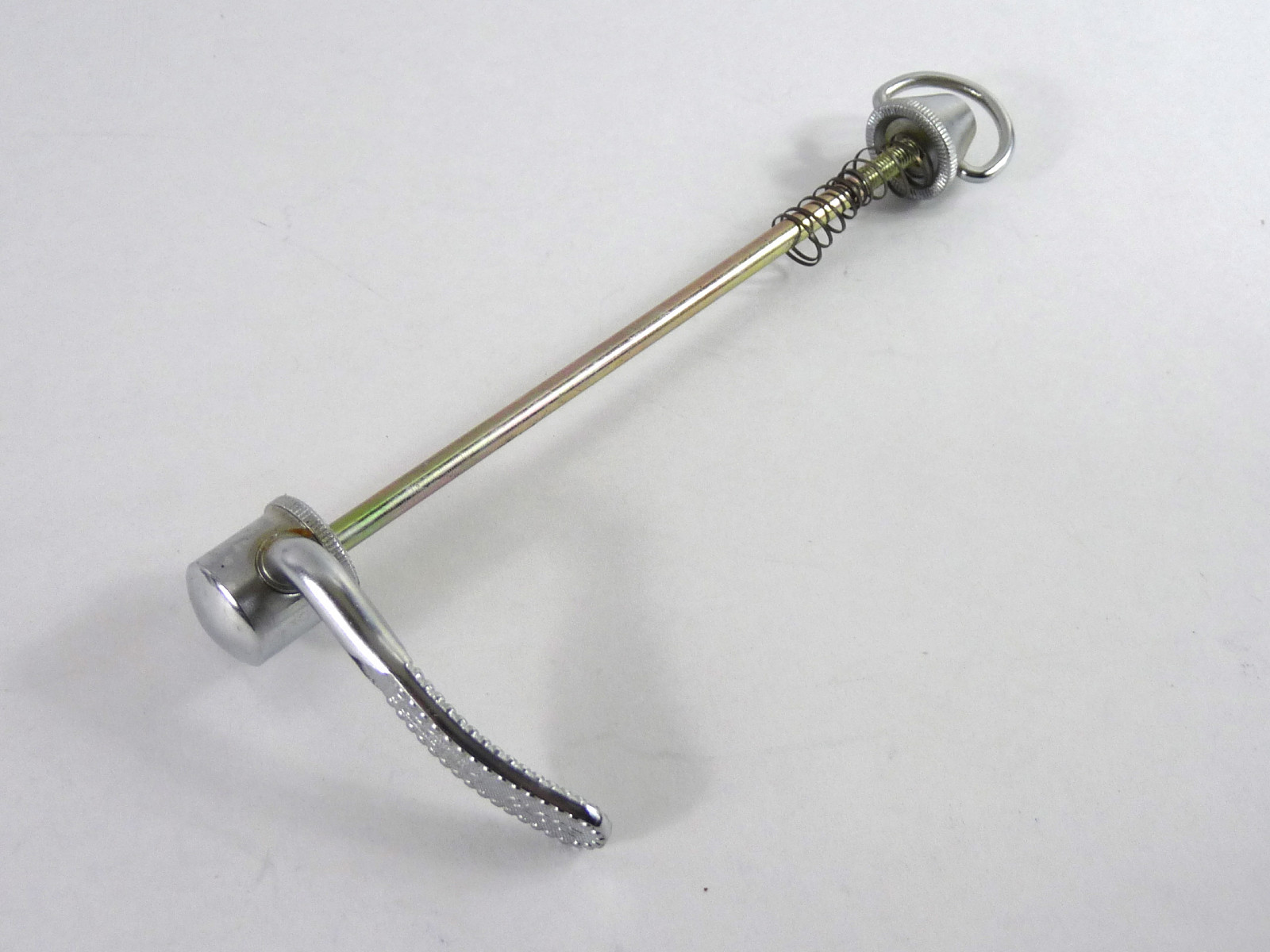

These lack the distinctive nut with the loop thing like these have:
Don't know how picky you are, but domed-end and no D-ring = Sunshine Pro Am, while conical end and D-ring = Superbe 1st gen.

The Conical with D Ring is what I wanted. are the QR bits the same om both?
