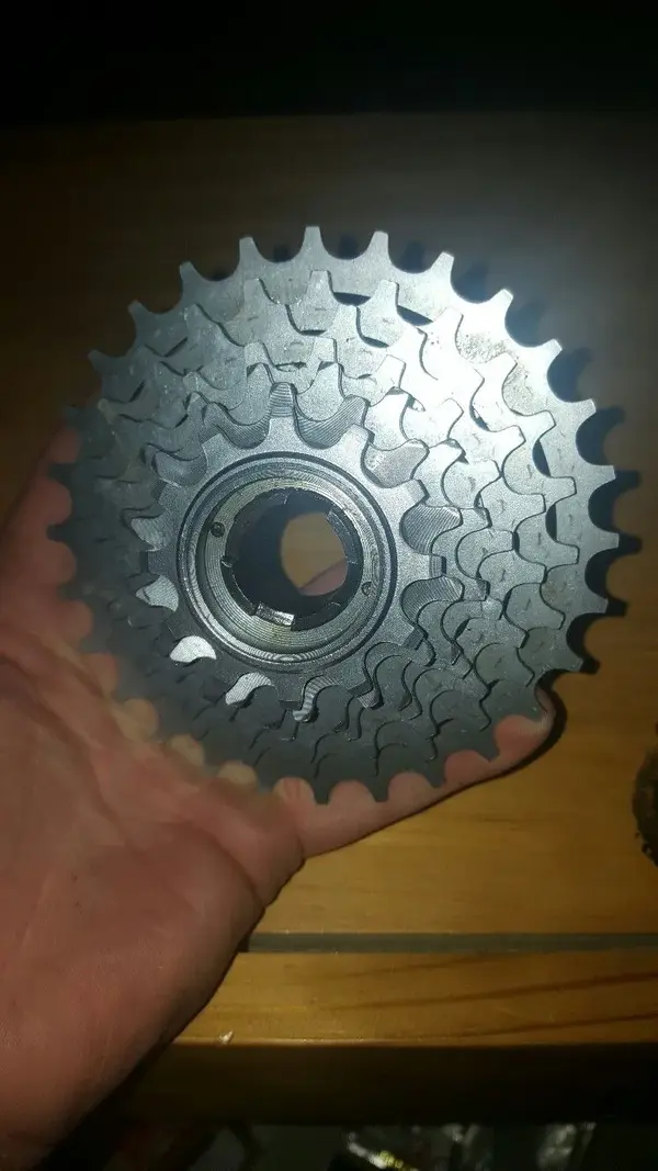

Are you sure it's not a freewheel though? My XC Pro hubs/wheels from 1990-91 use a 7 speed freewheel that is removed with a park tool 4 prong bit.

That I think, I'll get a pic in a min
This is my Suntour 7 speed freewheel
Note the area where the lockring would be on a modern cassette, it takes a 4 prong bit to unscrew the freewheel.
