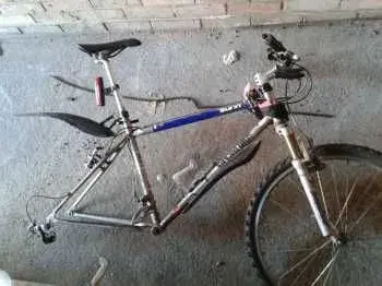

It's been a while since I've been on here. Other, non-bike-related stuff got in the way of my plans to sort out the front end position (forks/stem, etc.).
This is my only bike and most of the time is used for the 30 min commute to work, so reliability is key. Well, I have reached the point where I need to sort the drivetrain out.
The picture, if it works, shows the current situation. But now I have a dilemma and your input would be welcome.
The chain snapped on me the other day. It was old, so needed replacing anyway. When I then looked at the cassette and chainrings it became obvious they would need replacing too, so it would be a waste of money putting a new chain on knackered teeth. I know in the grand scheme of things this won’t cost me silly money, but I don’t have a lot of money to throw at this. Chains are cheap, and cassettes are cheap, but chain rings will bump the cost up.
As far as I can tell I’ve got three options:
a) Replace everything.
b) Go single speed.
c) Go 1x8.
SS really appeals and I can do the SS conversion cheaply, but this is my only bike, not an N+1 bike and I do have one hill to climb every day. I’m struggling to see the point in running three chainrings as I only ever use the top two (42 and 32t). A 36t would be a good compromise, if I kept 8 cogs at the back. And the old XT rear mech still shifts OK. At least, it will once I’ve tweaked it again.
Thoughts?

Nothing wrong with running 1x8 if it meets with your needs. If you're running off road, you will probably need some kind of chain device to stop the chain from jumping off the front ring on the bumpy stuff, or at least reuse the front mech to provide that function.
Regards
Right, I've bitten the bullet and decided to ditch the gears. The kit is on order from Charlie the Bikemonger in Dorset and with any luck I might get it before the weekend. I ride to get to work and to cross train for long distance running, so anything that provides a little extra leg-strength is no bad thing. More pictures when I'm done.
