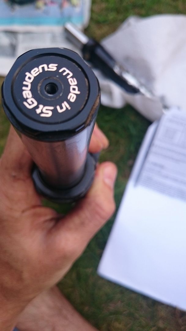

Are you sure about that? There should be a little screw covering the valve. 1.5mm allen key or something equally ridiculous, if memory serves. The valve itself is, as I'm sure you're aware, just a chunk of 8mm OD silicone rubber with a very fine hole poked through it.
If you've got an actual valve there, one of the legs has been modified. Does the "no valve" cap look like this (with or without small allen screw)?

Yes, you're right, Tufty! Cheers :wink:
They just had different screws in. 2mm allen is correct. And I have two spares now. 8)
